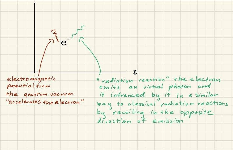

I meant Feynman diagram yes, here I tried to draw what I understand from this in form of some sort of Feynman diagram. Is this correct or am I really far away from understanding the radiation reaction in this case?
If this is somewhat correct I wonder what the the "electromagnetic potential operator photon"(the brown in the picture) would be addressed with in a Feynman diagram? Or is it that one could think of it as some positrons and electron pairs producing an electromagnetic field nearby which then accelerates the electron?

I meant Feynman diagram yes, here I tried to draw what I understand from this in form of some sort of Feynman diagram. Is this correct or am I really far away from understanding the radiation reaction in this case? View attachment 314090
If this is somewhat correct I wonder what the the "electromagnetic potential operator photon" would be addressed with in a Feynman diagram? Or is it that one could think of it as some positrons and electron pairs producing an electromagnetic field nearby which then accelerates the electron?
Another question that arose is in the case we are treating the phenomena of spontaneous emission in terms of radiation reaction + vacuum fluctuations = A Einstein coefficient for spontaneous emission. I know the A Einstein coefficient refers to the probability for a transition to occur. But I wonder how should I interpret it? For one single emission do we need both a vacuum fluctuation and a radiation reaction? Or is it rather that 50 % of the emissions happens due to radiation reactions and 50 % due to vacuum fluctuations, or other percentages depending on how you order the operators as we talked about earlier. The question is in other do we need either a radiation reaction OR a vacuum fluctuation for on particular emission to occur or do we need both, and both contribute equally to one particular emission?

Okey, I see, do you have any comments on this:
