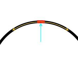

Consider the forces on a small section of the pipe...
This bit of the pipe isn't accelerating so Newtons law F=ma says the net force (F) in all directions must be zero. The outward radial force due to the pressure of the water is countered by tension in the copper. Copper isn't particularly elastic so not much deformation will occur to the copper pipe unless the pressure is very high. Obviously if the pressure is high enough to break the pipe the tension force will disappear and some of the pipe might "accelerate" :-)

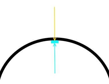

Even though water isn't very compressible it is being compressed very slightly. If you consider a small region of water near the pipe the forces on that must also sum to zero. The radial force from the rest of the water is balanced by the force of the pipe. So you can't really say that the pressure is "caused" by one or the other, it's both.
Now I think about it this must also be true for a system with an expansion vessel. In such a system the expansion vessel is what regulates the pressure when the water heats up or cools down but the forces will still be balanced as described above.
