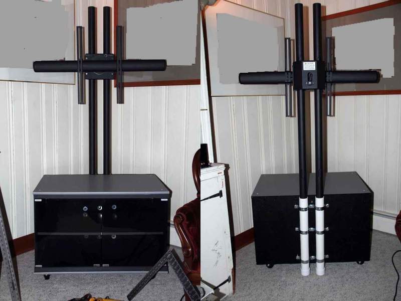

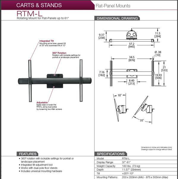

I am building a stand for my LCD/LED TV and Mount. See several pics below: Calculation Sheet, Mount Diagrams, and Side View of the TV. The Mount will be hanging on 2 poles, and the TV hangs on the front of the Mount.

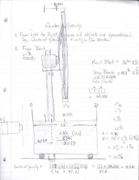

Am I computing the Center of Gravity correctly? in order to determine where to let the whole connected device hang, so it will be centered on my stand, distributing the weight at the center?
I show my Calculation Sheet in one of the attachments, but basically the final formula filled in with weights and distances is:
Center of Gravity = (4.75 in)x(36 lbs) + (10 15/16 in)x(49.8 lbs) / (36 + 49.8) lbs = 8.341 in
where
4.75 and 36 are the Center of the Mount and Mount Weight,
and
10 15/16 and 49.8 are the Center of the TV and TV Weight,
Length measurements are taken by setting the back of the Mount as 0. Then, later translating the interval to the back of the Stand.
The more I think about it, does the point of weight also have to do with the lever action of the 2 poles holding the weight up, on the stand? I also decided to let the poles rest on the ground, after passing them through my stand ... so this is really more about balancing the whole, so there is the least chance of it toppling over.
Please discuss and help me determine a best position for the 2, 2" holes for the poles.
Currently, I calculate 6.159 in. (center of poles being 3 in. from the back of the Mount) from the back edge of the 23 in. deep Stand, will place the Center of Gravity at 8.341 inches of the Mount and TV, over the center of the stand (from back to front).
Does this make sense?

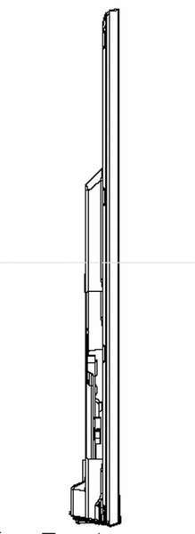

The Mount-ed TV does tilt 10º down and 35º up, so maybe the "thickness" of the TV needs to be modified ... or to simplify things, just do the calculation for an at rest vertical alignment. It does pivot along its centerline.

The Premier Mount poles I'm considering are 72 in. tall and 2 in. OD. They say the Shipping weight for Chrome ones are 21 lbs (for Black ones, 22 lbs):
http://www.premiermounts.com/product.asp?partid=93
That's for 2 of them.

billycar: For now, recompute your CG, as mentioned in post 2, including the weight of the vertical poles, but excluding the stand weight. Use the same method you used previously. The answer will slightly differ from your previous answer, 8.341.
If the vertical poles are steel, and if we are to believe the shipping weight, then it means the vertical tubes have a wall thickness of 2.11 mm; and therefore, the total weight of both vertical poles is 90.90 N (20.44 lbf).
billycar: Notice, your CG location now becomes 185.77 mm (7.314 in).
If the vertical poles did not rest on the ground, you would want the CG exactly over the center of the stand, in which case the centerline of the vertical poles needs to be 182.53 mm (7.186 in) from the back edge of the stand.
However, now that you decided to let the vertical poles fully rest on the ground, it no longer matters where the vertical poles are located. Interestingly, no matter where the vertical poles are located, you always get the same reaction forces on the caster wheels. Therefore, the best location for the vertical poles would be 182.53 mm from the back edge of the stand.
I get ... (using Shipping Weights of the Poles):
CG = {(4.75 in)x(36 lbs) + (10 15/16 in)x(49.8 lbs) + (3.0 in)x(21 lbs)} / (36 + 49.8 + 21) lbs = 7.291 in
where 3.0 in and 21 lbs are for the Center and (Shipping) Weight of Chrome Poles
For the Black Poles, the CG = 7.251 in.

A couple of other considerations will be the Tilt Movement of the TV: 10º upward, and 35º downward about its centerline (probably only making the TV virtually thicker for our calculations ... although its centerline should remain constant through this motion).
I will also be able to rotate the TV 90º to Portrait and Landscape orientations (I don't think this affects the calculations). To simplify the problem description, I decided to hold off on this until now.
billycar: The screen tilt and orientation do not matter, because the CG does not change appreciably. Secondly, the force at the center of the poles is already taken into account in the F1(xp) values. I updated the F1(xp) values, below, based on post 13.

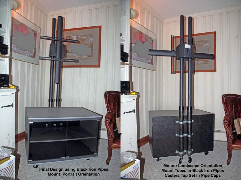

The metal Poles finally arrived, and now I have accurate weights for them ... and I have also re-checked my weights for the other components (and now am using the correct scale of lbs). My scale has both lbs and kgms on it, and earlier, reading it upside down, I picked the larger numbers, which are the kgms ... big apology ... my eyesight isn't the best. (1)
In response to the last message above: even though the poles are 72 in. high, I would not go much over 60 inches. I would want the center of the screen, landscape and portrait, no higher than eye level (5' 6"), with me standing. The bottom of the Stand is ~3.5" off the ground. Perhaps say 66" maximum height for center of the Mount and TV.
Actual weights are:
Mount = 24 lbs (2)
Stand = 105 lbs (3)
Stand Front = 45 lbs (4)
Stand Back = 60 lbs
Poles = 18 lbs (5)
HDTV = 49.8 (6)
I needed to add 4 lbs of PVC pipe and Pipe Pressure Clamping Rings, that the metal tubing will slide down into on the Stand. This weight is now included in the Stand at the 7" mark from the back.
Now CG Mount/TV/Poles = 7.7635 = (4.75 x 24. + 10.9375 x 49.8 + 3.0 x 18.0) / (24. + 49.8 + 18.0)
As an aside ... if I compute the CG of the Stand = 10.6786 = (5.75 x 60 + 17.25 x 45) / (60 + 45), what is wrong with lining up (plumb line) the CG of the Mount/TV/Poles with the CG Stand, and calling the whole balanced?
I would say that the poles would need to be located at 5.9151 in. = 10.6786 - (7.7635 - 3) from the rear, which would make this appear (to me) to occur.
Thanks for your patience

Points of Clarification Needed Deciding Where to Locate the Pipe Mounts
To place the CG of the Mount/TV/Poles over the CG Stand:
Location of Center of Poles = CG Stand - (CG Mount/TV/Poles - Distance from Back of Mount to Center of Poles)
________________________= 10.2857 - (7.7635 - 3.0000)
________________________= 5.5222
And this is measured from the back edge of the Stand, even though we measured from the 3.0 inch shift inward due to the wheels, since the CG Stand comes from the distribution of the weight of the Stand from Back to Front. (It is coincidental that the distance from the back of the Mount to the center of the Poles is also 3.0 inches.)
Suppose I mounted the poles to the back of the Stand:
Using my 2" I.D. PVC Pipe Mounts (2 3/8 O.D.), the Center of the 2" O.D. metal Poles would then be at -1 3/16 = -1.1875.
I would have greater relative stability from approximately 1.2 (at 5.5222) to 1.5 (at -1.1875). By stability, we are talking about tipping from front to back, and back to front?
It would make more sense to mount the PVC Pipes w/Poles on the back of the Stand?
Or is it better, in some sense, to have the PVC Pipes inside the Stand, contained within the spread of the wheels? perhaps at the new value above of 8.660?
billycar: The relative stability at xp = 5.522 inch is 1.127. Therefore, the horizontal tipping force, applied at a height of 63 inch above the stand bottom surface, would be F1(5.522) = 1.127*F1min = 1.127*(17.42 lbf), for xp = 5.522 inch. Tipping is from front to back, and back to front. A negative relative stability value means F1(xp) is applied in the back-to-front direction, instead of front-to-back.
The stability at xp = -1.19 inch is currently slightly higher than at xp = 8.66 inch. You can pick the stability you prefer.
I think I'll try mounting the Pole Pipes to the back: 26 (-1.19) lbf > 24 (8.660) lbf > 20 (5.522) lbf.
This design will also keep the top and shelf space for the Audio & Video components that would be lost due to my boring holes down into the cabinet ... although I liked the design idea of the pvc pipe pressure rings allowing fixed and up/down movement of the vertical Poles.
After trying the back mounting position, I could always go to the other design.
One other observation: even though the other positions have varying degrees of stability, the overall setup is still relatively stable. F1min = 17.42 lbf is more than a subtle breeze hitting the TV ...
Oh, what is the explanation for the change of sign for F1 between 8.660 and 9.0?
billycar: To be rigorous, we should have written F1(8.660)/F1min = +/-1.390, instead of 1.390. xp = 8.660 inch is a transition point, where the assembly stability is exactly the same in the forward and backward directions.
Finished project. (Background artwork removed)
Enjoyed the path to arrive at a solution: rear mounting of Pipes and Poles, providing optimal stabilization, and more efficient use of Stand surface area for A/V equipment.
I might now replace the PVC with metal pipe, and rest them on 2 swivel wheels, making it easier to move from one location to another, and to simply swivel the entire setup from left to right.

Final Design
Stand Pipes using Black Iron Pipe
Casters Tap Set in Pipe Caps
TV Mount Shown in Portrait and Landscape Orientations
