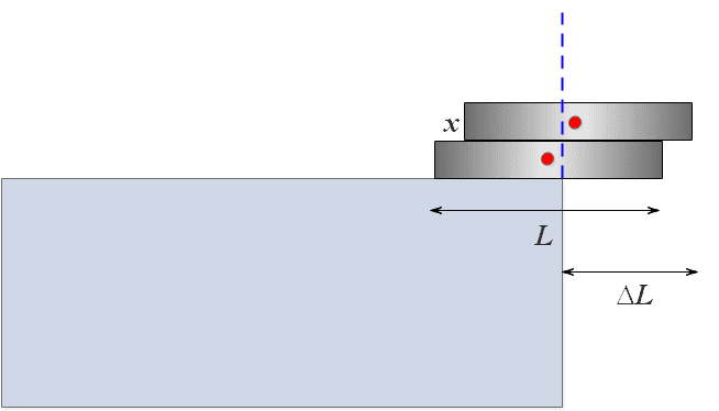

Two identical blocks are stacked from the edge of a table, as the figure below shows. If each block has a length ##L##, what is the maximum overhang possible?
The center of mass (or gravity) : ##x_{\text{CM}} = \frac{\Sigma m_i x_i}{\Sigma m_i}##
The red dots show the CM of each block. ##x## is the amount by which the upper block overhangs the lower block. The blue (dashed) line shows the CM of the combination. For maximum overhanging, this line lies on the edge of the table below. By symmetry, the CM lies exactly midway between the two CMs of the individual blocks - hence each CM must be a distance ##\frac{x}{2}## from the CM of the combination (on either side). The amount of overhanging ##\Delta L = \frac{L+x}{2}##. Question is then, how to relate ##x## to ##L##?
I could not progress further.
You have correctly identified when both blocks together will fall off if they were glued together, but they are not. What happens as you increase ##x##? What will happen to the upper and lower blocks, respectively?

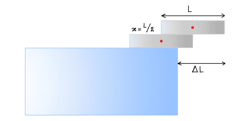

I must redraw to be able to visualise the thought development which your queries provoke. My original diagram up there is clearly inaccurate (given the distances I now realize).
246377
Ok so with a better drawing, I find that, given ##x = \frac{L}{2}\Rightarrow \Delta L = \frac{L+\frac{L}{2}}{2} \Rightarrow \boxed{\Delta L = \frac{3L}{4}}##, using the formula I derived above.
Again, from the redrawn figure above, we see that ##\boxed{\Delta L} = \frac{L}{2}+\frac{x}{2} = \frac{L}{2} + \frac{L}{4} = \boxed{\frac{3L}{4}}##.
Likes Orodruin
Yes, this is correct.

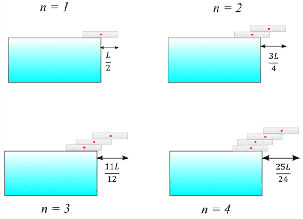

If you want a harder problem in the same spirit: Add another block, and then another, and then another. Is there a limit to how far the overhang can become?

I have been able to do it for four blocks for which I put the image as below.
As you can see, for ##n=4##, the overhang is greater than ##L##! That means the topmost block is entirely out of the table ##-## a fact I didn't expect.
What I am not sure of is whether one can go on. Can the overhang reach ##2L##? I suppose it would be instructive to calculate the overhang ##\Delta L## in terms of the number of blocks ##n## and the length of each block ##L##.
brotherbobby said:
I suppose it would be instructive to calculate the overhang ΔL in terms of the number of blocks n and the length of each block L.
Indeed. You should get a clue by seeing how much each extra block adds in the cases you show above. What is the sequence?
