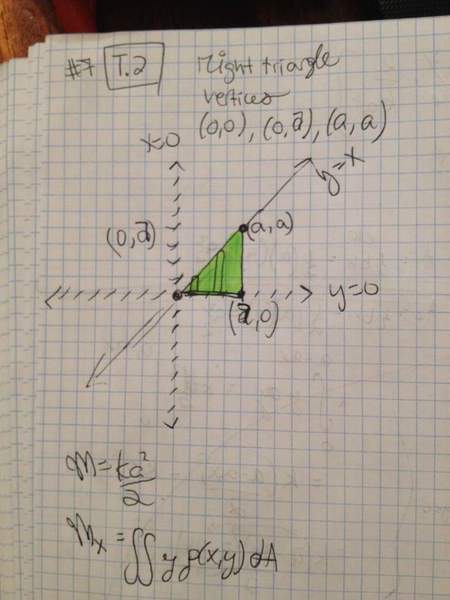

Find the center of mass of a planar lamina, in the form of a triangle with vertices (0,0),(0,a),(a,a),
if ρ=k
m = ∫∫f dA
xbar = My/m
ybar = Mx/m
mass = ka²/2
Mx = ∫∫yk dy dx
My = ∫∫xk dy dx

Below is my photo:

If the density is a constant, the "center of mass" is the "centroid", the geometric center of the figure. And for a triangle that is particularly simple to find. If you really want to use the double integral, x goes from 0 to a and, for each x, y goes from 0 to x:
[tex]m= \int_0^a\int_0^x k dydx[/tex]
[tex]M_x= \int_0^a\int_0^x kx dydx[/tex]
[tex]M_y= \int_0^a\int_0^x ky dydx[/tex]
Aw sweet, turns out I had the wrong variable in my Mx & My formulas, kept getting the thing wrong:)And for symbols, my screen just shows "quick symbols", none of the fancy LaTex y'all are using ^^
Okay actually I do have a question, in my book the formula for Mx is double integral of ky dA
And for My is double integral kx dA Which is correct?
What do you mean "which" is correct? [itex]M_x[/itex] is the moment of inertia about the x-axis and is [itex]\int\int ky dA[/itex]. The y coordinate of the center of mass is [itex]\overline{y}= M_x/m= \int\int ky dA/m[/itex] and the x coordinate of the center of mass is [itex]\overline{x}= M_y/m= \int\int kx dA/m[/itex].
Personally, I find the "[itex]M_x[/itex]", "[itex]M_y[/itex]" notation "non-intuitive" and prefer the [itex]\overline{x}= \int\int kx dA[/itex], [itex]\overline{y}= \int\int ky dA[/itex] notation.
oh! Yes :D Excellent, thank you for clearing that up.
