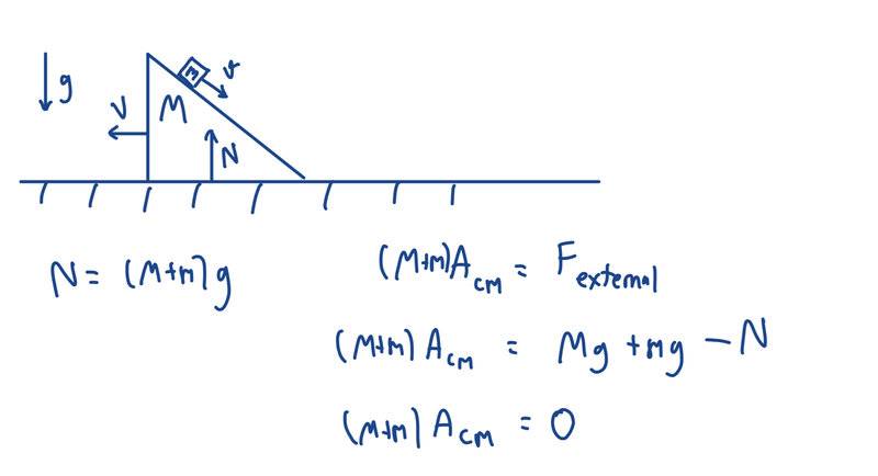

Mass m is on top of an inclined plane of mass M, let mass m slide down. (All surfaces are frictionless) I’m trying to find the center of mass’s acceleration.
(m+M)Acm=Fexternal
Why is the center of mass acceleration zero? Did I do anything wrong?

There is no net external force on the system in the horizontal direction. Although I don't think you properly analyzed it, because in the vertical direction the center of mass is accelerating.

The vertical coordinate of the combined center of mass ( block and ramp) is accelerating as the small block accelerates down the ramp. What you did is not correct.

How can I calculate Acm in the y axis? I know that the center of mass is accelerating down in the vertical axis but I don’t know how to calculate the external forces acting on it.

They don't cancel out the way you think they do or imply they do in your calculations. Imagine a block on a scale. The scale reads ##mg##, now take that block and scale lift it up and drop it, what does the scale read while it's in freefall?
It’s zero. So does that mean my Normal force here is incorrect?

Yes, the normal force on the base of the wedge is incorrect. That little block has some aceleration in the vertical direction between ##0 ~[m/s^2]## and ##g##(freefall) in magnitude.

Not directly. The problem is that downward acceleration of the mass centre is limited by the horizontal inertia. You cannot solve for the two directions independently.
You could look at the kinematic relationship between the vertical and horizontal positions of the small mass (since the horizontal relationship of the two objects is known) and/or consider work conservation.
A sure way, but maybe longer, is to consider the normal force between the objects and apply F=ma to each separately.

The first thing to note is that the small mass has some velocity ##\vec v## relative to the ground; and, it has some velocity ##\vec v'## relative to the block. And, the block has some velocity ##\vec V## relative to the ground.
Imagine what happens in a small time interval ##\Delta t##:
1) The block will have moved ##\vec X = \vec V\Delta t## to the left.
2) The small mass will have moved ##\vec s' = \vec v'\Delta t## down the block.
3) The displacement of the small mass relative to the ground is the vector sum of these two displacements:$$\vec s = \vec X + \vec s'$$4) And, the displacement of the small mass can be expressed in terms of its velocity relative to the ground:$$\vec s = \vec v \Delta t$$Note that by differentating these equations we can see that the acceleration of the mass is the vector sum of the acceleration of the block and the acceleration of the mass relative to the block:$$\vec v = \vec V + \vec v'$$$$\vec a = \vec A + \vec a'$$Any solution will have to deal with the relative motion of the objects. So, I think these equations are your starting point.
I had a look at this and found a relatively elementary way to do things. Note that in the ground frame:
1) The horizontal displacement of the mass and the block are related.
2) The vertical displacement of the mass is related to the horiziontal displacement. To calculate this, draw a diagram of the starting position and another diagram when the mass has moved some distance down the slope.
3) Express the KE of the system in terms of the vertical displacement of the mass.
4) The PE lost by the system can, of course, be described by the vertical displacement of the mass.
5) Combine and solve those equations to get the vertical acceleration of the mass.
6) Calculate the acceleration of the CoM from that.
