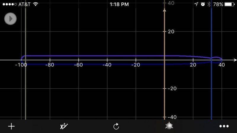

How would one go about finding the center of mass of a non-uniform rod when its cross-section has been modeling using a piecewise-defined function?
For a specific case let's use a drumstick, noting its volume as a sum of half of a sphere (the 'butt' end), a cylinder (the 'shaft'), the majority of half of an ellipsoid (the 'shoulder'), and the majority of either a smaller sphere or smaller ellipsoid.
With an ellipsoidal tip, the piecewise-defined function for its cross-section is given by:
f(x) = sqrt( (3)^2 - ( x + 97 )^2 ), x<-97;
f(x) = 3, -97 < x < 0;
f(x) = (3)*sqrt( 1 - ( x / 36 )^2 ), 0<x<32.8456;
f(x) = (2)*sqrt( 1 - ( ( x - 36 ) / 4 )^2 ), 32.8456<x=<40
(The value "32.8456" was obtained using equations related to the 'vesica pisces')
Now... If I were to take the integral of each piece... could I not easily compute the volume of the drumstick by squaring my sum and multiplying the result by π?
That might get me the volume, but I need to construct an equation for the object's linear density... I have read about one function called 'unit step' and another called 'heaviside', but am not sure which one would be appropriate, let alone how to input my pieces into the process...
The goal I am shooting for, assuming I can acquire an equation for the 'linear density' and 'center of mass' is to find the 'center of percussion'...

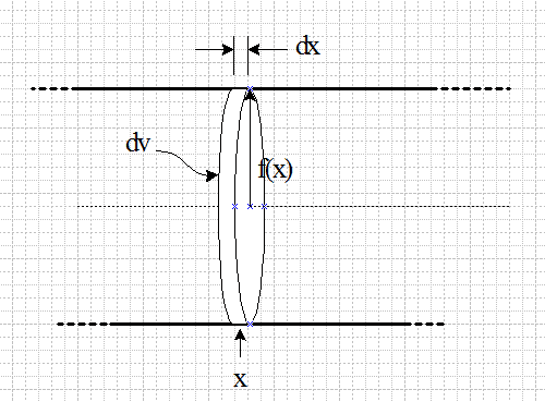

Integrating over x is the right idea. But you want to sum volume elements. Don't sum first and square later! Slicing the stick into thin disks of differential width dx, each having a cross sectional area related to the radius at the x location. So ##dv = \pi f(x)^2 dx##. Integrate to sum up all the volume elements. So, sum the squares rather than squaring the sums!
If the material is of uniform density (such as a uniform piece of wood), multiply the volume element by that density ##\rho## to yield the mass of that volume element. So then each mass element is ##dm = \rho \pi f(x)^2 dx##.
You should be able to work out how to find the linear mass density and center of gravity with the above machinery :smile:
