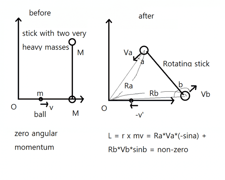

look figure (b)
suppose that baseball deliver F through horizontal motion.
imagine that the O point of the system is same line of F (+x is F direction)
then before percussion, the angular momentum of the system is "0" because r and v of baseball are same direction (L = r x mv = 0)
so after percussion, the ball gets y direction velocity because if bat has angular momentum, the other angular momentum has minus sign and same size so that make 0 angular momentum
that means center of mass of baseball bat has y direction velocity cause of conservation of linar momentum so that make y direction linar momentum also be 0 before and after percussion
so if the baseball hits bat like figure (b), the bat never move just x direction like figure (b)
sth problem in my inference??

In the case of an off-center impact, the ball starts with non-zero angular momentum in the reference frame where the center of the bat is at the origin. There need not be (and can not be) any motion in the y direction as the result of a collision with force along the x axis.

center of the bat is at the origin → i know that makes the ball starts with non-zero angular momentum
i mean that if i set the origin point it same line with ball's movement, that makes the ball and bat get zero angular momentum - and after the collision, angular momentum of totaol system is not anymore zero

What makes you say that the angular momentum becomes non-zero after the collision? It is not true.
Edit to add:
Conservation of angular momentum applies in the absence of external torques. If total angular momentum is zero before the collision, it must be zero after.

fig (b) has no pivot - it's a free laminar motion
i know no external force means conservation of angular momentum
and i understood fig (b) must be same angular momentum
but it's also true that my set of origin point(same line with F) makes zero angular momentum before percussion because r and v have 0 angle, and after collision non-zero angular momentum because bat the will spin and ball move -x direction
i just want to know problem of my inference
What makes you say that the spinning bat will have non-zero angular momentum? It is not just spinning. It is moving rightward as well.

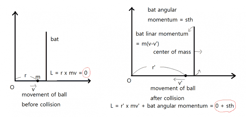

sgh1324 said:
physics world of mine
What makes you think that the angular momentum of the spinning bat is non-zero?
if spinning bat has two mass top and bottom of it - for easy calculation . that angular momentum i think is non-zero
In that diagram, where is your reference axis? Recall that you had originally placed that axis at the point of impact of the ball. Not at one end of the bat. Not at the midpoint of the bat.
Angular momentum is only conserved if you are consistent in your choice of reference axis and do not move it around, willy-nilly.

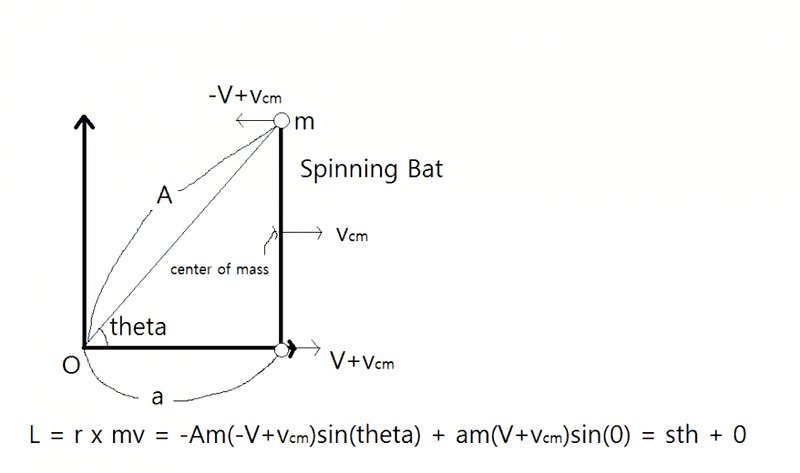

OK PLZ UNDERSTAND MY QUESTION
Problem - if ball collasped with stick hangs two heavy masses and moved like test.png, After collision angular momentum must be zero cause no external forces there. But collision makes stick get spin, at origin point of that system feel non zero angular momentum
your insist is "Ra*Va*sina=Rb*Vb*sinb" ??
I insist that the spinning bat has zero total angular momentum about the reference axis that you have originally chosen.
The fact that it has non-zero angular momentum about a different axis is completely and totally irrelevant.

what makes you think that i calculated at different axes, before and after are same axes, they are just fixed simple axes. i calculate angular momentum about the reference axis after collision
The reference axis that you claimed you chose was one at rest at the position of impact of ball on bat. The reference axis you ended up using is apparently one at rest at the position of the center of mass of the bat just prior to impact.
Your insistence on invoking trig functions is also erroneous, but we need not go there. [The angular momentum of the spinning bat is constant -- it does not vary as the bat rotates]

Looking more slowly through your most recent drawing, I see that this time the reference axis has not moved. That's good.
You show the ball rebounding at a speed of -v purely along the x axis. That may or may not be correct, depending on the mass of the bat and the coefficient of restitution. But since that motion is aligned with the axis of rotation, it is irrelevant.
You show one mass (a) representing the top end of the bat rotating counter-clockwise with a velocity of Va on a moment arm labelled Ra so that the velocity makes an angle "a" with the moment arm. That gives you an angular momentum term of ##m_a V_a\ sin\ a##
You show another mass (b) representing the bottom end of the bat also rotating counter-clockwise with a velocity of Vb. on a moment arm labelled Rb so that the velocity makes an angle b with the moment arm. That gives you an angular momentum term of ##m_b V_b\ sin\ b##
You claim that this sum is non-zero, that it is equal to "r x mv" and that it is equal to the angular momentum of the bat.
I agree that it is equal to the angular momentum of the bat.
I do not agree that it is equal to "r x mv" -- [actually it's r x 2mv but r=0, so that comes out OK]
I do not agree that is is non-zero.
Looking at a partially-rotated bat is not a particularly effective view. It adds unnecessary complexity to the problem. Better to look at the vertical bat immediately following the collision. Let us assume as is implicit in your most recent drawing that the ball collides exactly at the bottom end of the bat.
In that position, Va will be zero, Ra will be pointing straight up. sin a will be undefined but that is irrelevant. The angular momentum of mass a is zero.
Vb will be non-zero, Rb will be zero. sin b will be undefined but that is irrelevant. The angular momentum of mass b is zero.'
So the angular momentum of the bat is zero. By conservation of momentum, this angular momentum does not vary over time.
