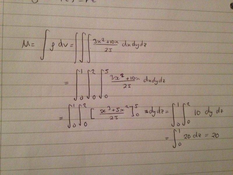

a) By substituting the density function into the Total mass integral and doing a triple integral over dxdydx, i get:
M = ∫∫∫ (3x2 +10x) / 25 dx dy dz = ∫∫ [(x3 +5x2) / 25] dy dz with limit of 5 and 0.
From there I continue and get an answer of M = 20 units
My problem arises in part b) when I do:
(1/M) * ∫xdm = (1/M) * ∫xρ dx = (1/M) * ∫ (3x3 +10x2) / 25 dx and use the limts of 5 and 0, i arrive at an X-coordinate for the centre of mass as 1.77. This doesn't make sense to me as surely with the stated denisty function, the mass if increasing as you progress from x=0, resulting in the COM being shifted towards the x=5 end?
Any help would be appreciated !

This is how i did the mass integral
That's fine.
How about integral in the numerator for the COM calculation?
In getting the COM, you forgot to integrate with respect to y. Your answer should be 2x as large.
