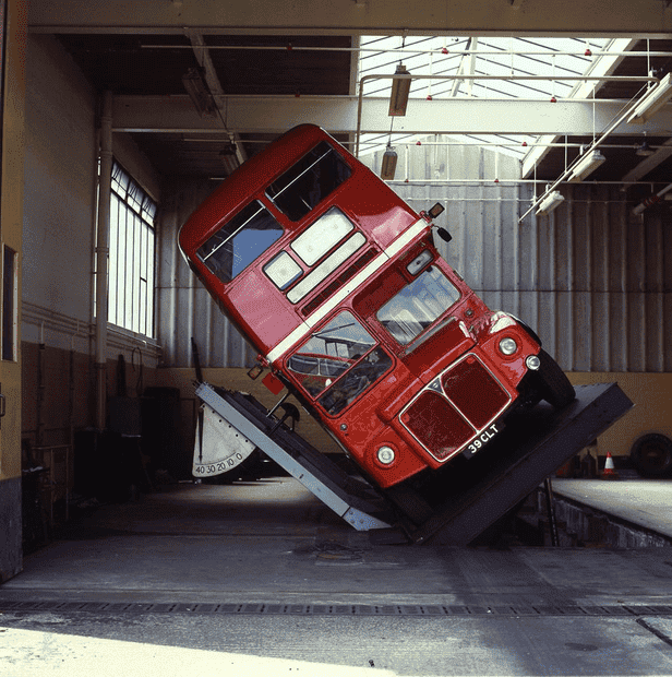

https://www.quora.com/Why-do-double-decker-buses-not-tip-over said:
In the UK, British transportation regulations required that double decker buses be tested on a tilting ramp, to an angle of 28-degrees.
Note that this is 28 degrees from the vertical, not 10 degrees from the horizontal. So the relevant formula will change slightly from the one you have used.
With those tweaks in mind, I get the book answer to two significant digits.
Edit to add graphical image
https://www.ltmuseum.co.uk/collections/collections-online/photographs/item/2002-18969 said:
