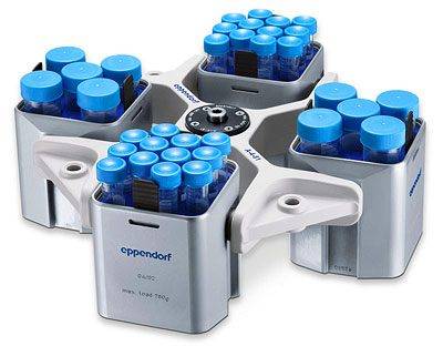

A lab mate and I got into a discussion on how to properly balance a swing bucket rotor. This is different than a normal centrifuge in that there are buckets that swing out once spinning begins. In a standard centrifuge balancing is simple - it's just the same weight directly opposite your sample.
I've attached a picture of "A" and "B" - which is the correct way to balance the centrifuge?
I argue that there is a vector Force (both a horizontal and vertical). One balance accounts for both, while the other only accounts for the horizontal. Arguably, the horizontal is much larger than the vertical, and it might not make a difference to not balance the vertical force..unless you have a huge amount of weight or extremely fast spin (and extremely fast spins do not use swinging buckets).

Hi Andrew,
Yes, essentially that is what we're trying to do. Except, it's a little more complex because the bucket does not have just one space where mass is held during the spin. These buckets have several slots, and hold multiple tubes. When swinging, there are tubes that sit vertically above and below the "post". Thus, when swinging, I expect there to be both a vertical and horizontal force (the vertical force being a result of the centrifugal force).
I've attached a picture of an actual swing-bucket rotor:
So, you can imagine that, when spinning these buckets swing out, so the blue caps of the tubes face inward toward the rotor. If you only wanted to load two tubes (in the 5-slot buckets), how would you balance all of the forces? Also, assume you don't load the tubes in the center slot (too easy!)I've attached another drawing of the buckets while spinning. Basically I just want to know if there is a vertical force component.

One of our centrifuges is like this. Balancing the rotor is the usual procedure- the tubes are identical sizes and equal weights, arranged symmetrically. to use only 2 50 ml conical tubes, put one in each bucket, opposite from each other (in this case, each would take the center position. If you have 3 tubes, make a 4th 'dummy' tube with water and arrange 2 tubes on each side.
To be sure, we aren't spinning faster than 1500 rpm, so we can tolerate small loading imbalances.

Dr. Resnick,
We do know the basics of balancing the centrifuge, and this question is more of a technical one, as loading in either orientation as I described above results in no disturbance while spinning. The vertical force is so small compared to the horizontal, that it's likely negligible. That is, at standard spin speeds and tube weights. However, now we have egos at stake and must have the technical answer.
The correct loading would be option C, with the tubes in the center. A would be better than B, but neither A nor B are "correct".
