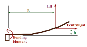

We can often hear that centrifugal force don't exist in reality...Helicopter mi-26 can lift 56tons ,it has 8 blades,so each blade hold 7 tons of force!
Do you know if you put 7tons at blade when blade is not rotating(static) ,bending moment will be way too much and blade will broke at root.
But when blade is rotating centrifugal force "straighten" blade so centifugal force basicaly "reducing" bending moment and this is reason why so tiny blades can hold so much load on it..
So how you can say,that centrifugal force don't exist?
centifugal force has outward direction so it cause tension in blade..

Because it doesn't. The force on the blades is centripetal force, an inwards force applied by the fastenings at the hub. This force is pulling the blades into a circular path; withou that force they'd go flying off in a straight line at a constant speed just like Newton's first law says they should.
But you are right that the tension in the blades is what straightens them out - it's just that the tension comes from the inwards-directed centripetal force and not the fictitious centripetal force.
force with inward direction (so called centripetal)will cause compression of blade,in reality blade is in tension so force has outward direction..
if you put load-cell between hub and blade it will show tension not compression..

This is only true if the blade is not accelerating. A rotating blade is accelerating

Agreed, but that fact is not incompatible with what @Nugatory and @Ibix said. We all agree that the blade is in tension.
What you said that is incorrect is that an inward force implies compression. That is not correct.
If you imagine cutting the blade at any point along its length you wind up with two surfaces. One surface is the outward facing surface of the part of the blade attached to the center, and the other surface is the inward facing surface of the part of the blade that is “free”. In tension the second surface has a force pointing inward, this is the real centripetal force and it is an inward force that is present in tension.
If you had an inward pointing force on the first surface then that would be compression.

Every part of the blade (except the last bit) has a inwards force (from the next inner part) and a smaller outwards force (from the next outer part), The net force from these two real forces is inwards, to allow circular motion in the inertial frame.
The outwards force, that people say doesn't exist, comes into play in the co-rotating frame where the blade is at rest. It cancels the net real force inwards, to make Newton's 2nd Law work in that frame. It's only used to explain the acceleration (or the lack of it) in the non-inertial frame. It has nothing to do with the measurable tensions, which are frame invariant.

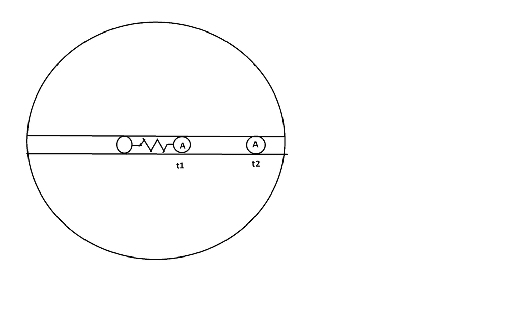

But if I called centrifugal force "reactive centrifugal force" than everything is OK?
Imagine ball connect to the blade in the way that can slide in and out .When blade start rotate ball will moves outward.
What is force which push ball outward in inertial frame of reference?
Or how centrifugal clutch works if centrifugal force "dont exist"(whatever that mean)?

There are two different outward forces mentioned in my post. They are not the same thing and must not be conflated, so you need two different names for them. I don't care which you use, as long you have two different ones.
Moving in a straight line also brings you away from the center (outward), but you don't need a force to move in a straight line in an inertial frame.
In an inertial frame the ball never accelerates outward. Don’t confuse “move” with “accelerate”. Forces are required to accelerate, not to move. There is nothing inconsistent with Newton’s laws in moving outward without an outward force as long as there is never any outward acceleration.

if i put ball close to blade root when blade is not rotating,than start rotate blade,ball will accelerate outward,so which force push ball outward?
Aeronautic Freek said:
...wich force push ball outward?
In which frame? What is the acceleration of the ball in that frame that needs to be explained by a force?

i know that in non-inertial frame is centrifugal force..
so i ask for inertial frame..

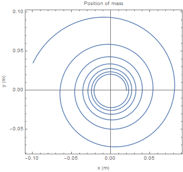

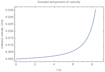

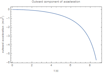

The contact force with the blade pushes the ball outwards. If you put a ball at rest on a frictionless turntable, then the ball stays at rest (in an inertial frame) when the turntable rotates. If there is friction, the friction force pushes the ball as the turntable rotates.
The ball never accelerates outward. It only accelerates tangentially.

... the ball is constrained to move in the radial direction (relative to the rotating blade). To remain at rest (relative to the blade) would require a centripetal acceleration. If there is insufficient friction for this, then the ball has no option other to accelerate outwards relative to the blade.
The real force is a tangential force in the rotating frame, but this tangential direction is constantly changing in an inertial frame, which results in constrained radially outward motion.

If the ball is unconstrained (no friction, not in a trough that forces it to move along the length of the blade, no mechancal connection to the blade, ...) it won't accelerate outwards. It will stay put (Newton's first law) while the blade moves out from under it, and then it will fall straight to the ground.
In any realistic situation, there will be some frictional force on the ball as it wants to stay put while the blade moves under it (this is how we can use flatbed trucks to move things around). This force will have a radial outwards component and that's what pushes the ball outwards.
