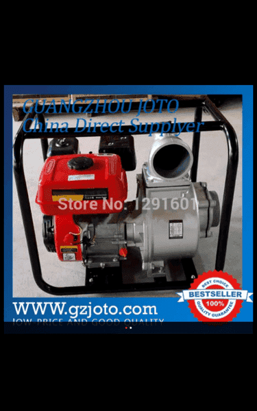

It is a water pump designed to move water, not propel a boat. I am just seeing if its use can expanded to another aplication.
I posted a photo of it earlier today.
What edison used to make a lightbulb work was not designed to be a lightbulb filament...
This is the same problem I run into where ever I go. Why do it rather than how to make it work. Thanks for your time.

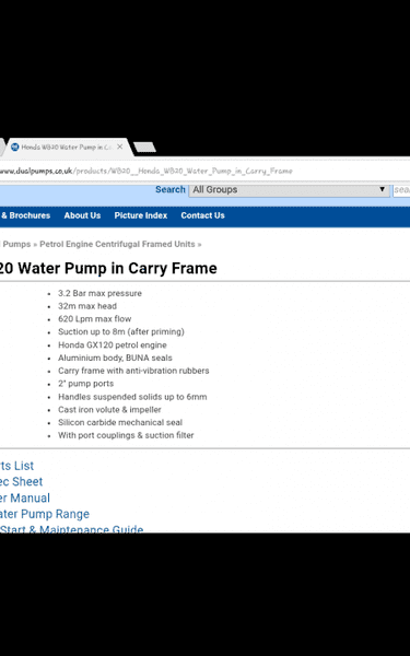

  • #31
I uploaded the data sheet... Let me know if you need anything I can provide.

I was hoping for a proper technical data sheet . One with pump performance characteristics .
Without this information we don't know the relationship between pump delivery pressure and flow rate . We could make some guesses based on known performance of similar pumps but I'd rather have solid data to work with .
Go to the actual manufacturers site and see if there is anything useful there .
  • #35
Dan Steill said:
7.5hp. 100m³hr flow rate. 4 inch inlet. 4 inch outlet. ~50 psi
Pardon my units, but ...
100m³hr = 440 gpm
50 psi * 144/62 = 116 ft
water horsepower WHP = QH/3960 = 440 * 116 / 3960 = 13 BHP (assuming 100% eff.)
so you see, the listed 7.5 hp doesn't correlate to the flow & head. You really do need the pump curve from the manufacturer to begin. Plus as mentioned above, it will show you the head vs flow.
