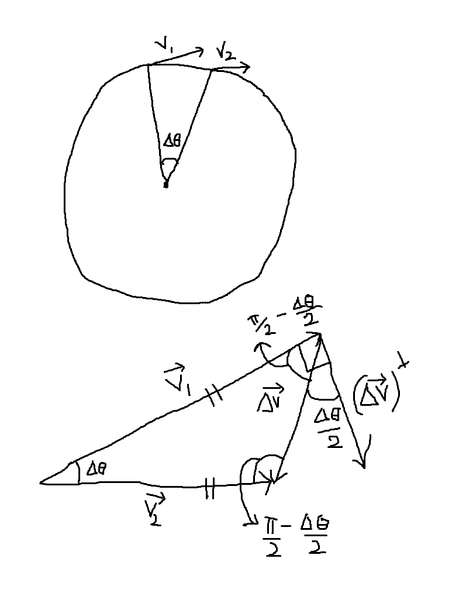

Ok, so I'm a bit confused by the derivation of a=v^2/r in Feynman's "Six Not-So-Easy Pieces".
In pages 17-18, it is stated that "The other component of acceleration, at right angles to the curve, is easy to calculate, using Figures 1-7 and 1-8. In the short time Δt let the change in angle between v1 and v2 be the small angle Δθ. If the magnitude of the velocity is called v, then of course Δv ┴ = vΔθ and the acceleration a will be a┴ = v(Δθ/Δt).".
1) What velocity does he refer to by v?
2) How can he multiply Δθ (an angle) by v (a magnitude of a velocity)?
3) (Probably the same as 2) How can he divide Δθ by Δt?
I haven't read the rest of the book, so maybe that's where the answer is? I don't know, it seems very weird.

Yeah, but he multiplies speed by an angle, and he gets velocity! How? And then he divides an angle with time, and multiplies it by speed, and gets acceleration!
An angle is a ratio of two length and thus itself dimensionless, namely arclength of the section of a circle divided by the radius of the circle. So any quantity multiplied by an angle is another quantity with the same dimension as the one you multiplied with the angle.
Ah, I think I am beginning to understand! So this angle would be measured in radians, not degrees, right? But what does this achieve though? What does multiplying an angle by speed achieve in this context?
When you rotate the radius by an angle θ, the arc described by the tip of the radius is s=Rθ.
Here the radius is v and the angle is very small so the cord and the arc are assumed the same thing.
$$\triangle{v(\bot)}=\sqrt{v1^{2}+v2^{2}-2\cdot{v1}\cdot{v2}\cdot{cos(\triangle\theta)}}\cdot{cos(\triangle\theta/2)}$$
=$$\sqrt{2v^{2}-2v^{2}\cdot{cos(\triangle\theta)}}\sqrt{\frac{1+cos(\triangle\theta)}{2}}$$
=$$v\sqrt{1-{cos(\triangle\theta)}^{2}}$$
=$$v\cdot{sin(\triangle\theta)}$$
=$$v\triangle\theta$$

Oh thanks, I get it now!
