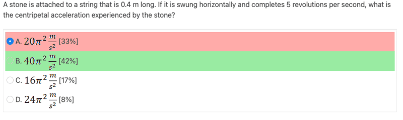

I can't seem to figure out the answer for this question with formulas given.
Angle of rot= arc length/ radius
Angular velocity= angle of rotation/ time
v=rw (v=tangential veloctity) (w=angular velocity) r= radius
centripe acceleration= v^2/r
So my initial understanding is that it completes 5 revolutions per second. I converted the 5 rev to radians, so each revolution is 2pi. Now since I got angle of rotation I can plug it into the angular velocity formula which is Angular velocity= angle of rotation/ time. However since I don't have time I can change the formula to angle of rot x frequency. Frequency in this case would be 5. So ang Velocity is 10pi rad/s. From their on I get the tang velocity and plug it into the centrip acceleration formula, however I keep getting the wrong answer. Is there anyway to solve this with the equation given below or am I missing any equations.
Right so far.
I cannot tell where you went wrong if you do not show your detailed working.

my question is that is 2pi the angle of rotation or is that the angular velocity.
Oh wait I think I figured out my mistake. The 5 revolutions per second is the frequency am I correct? How would that be stated as a period
There is no specific angle of rotation in the question, only a rate: 5 revs/s ##=10\pi^c/s##, where the c denotes radians.
Likes MatinSAR
The rotation period is the time to complete one revolution.
Likes MatinSAR
singh101 said:
so is the 5 revolution per second the frequency or period. I am assuming that is the frequency. If it is the frequency then what would the period be stated as if it were given in the question.
5 revs/s is the rotation rate. "Frequency" needs to be distinguished from "angular frequency ". The frequency is the number of revolutions per unit time, 5 per second, whereas angular frequency is the number of radians per unit time.
In equations like ##v=\omega r## and ##a=\omega^2r## use the angular frequency.
Likes MatinSAR
oh ok so 5rev/s can be converted into rad by multiplying it by 2pi which gives is 10pi rad/s. This then in added to the formula v=rw. so w is 10pi x 0.4. which gives us 4pi. This is then put into the formula v^2/r (4pi)^2/0.4= 40m/s^2. Am I correct?
Likes PhDeezNutz
Yes. Or you can use ##\omega^2r## for the centripetal acceleration instead, skipping finding v.
Likes MatinSAR and singh101
Oh ok thank you so much I understand where I made the mistake.
Likes PhDeezNutz
