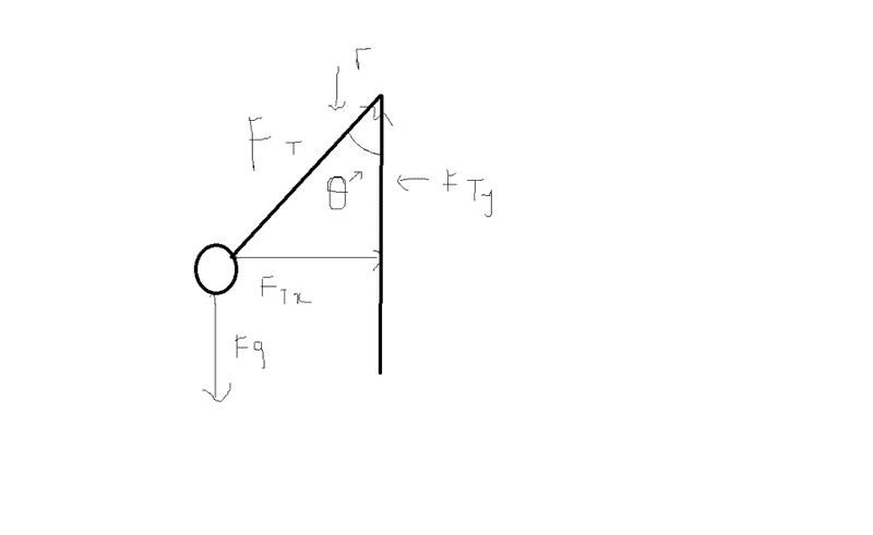

So referring to this lab , http://static3.mbtfiles.co.uk/media...ureate/physics/824297/html/images/image12.pngIn this lab you are holding the plastic tube and twirling it to make the small mass spin in a circle. Keep in mind there is a mass on the bottom.
I have to create an expression for Fc with theta and radius.
Fc = 4pi^2rf^2 * m
Well from the FBD of the small mass, we know that FC = FT
and from the FBD of the mass at the bottom we know that FT=FG.
Therefore for the system, wouldn't FC = FG of the mass on the bottom?
As for the equation i am not really sure were to start, could someone help me out please.
The string attached tot the mass going in a circle is angled downwards a bit, that is the horizontal plane in which the mass is circling is a bit below the top of the tube. That is the theta that is mentioned. Best to draw a diagram and post it.
so i know the lab looks something like this, and the Fg of the small mass will cancel out the fty in the tension, therefore ftx controlling the motion.

Yes, the x component provides the centripetal force.
