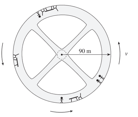

I'm not asking for a full on solution to my question, but instead wanted to know what was the difference in these two questions. So, here are the two questions
1) A space station of radius 90 m is rotating to simulate a gravitational field.
What is the period of the space station’s rotation so that a 70 kg astronaut will experience a normal force by the outer wall equal to 60% of his weight on the surface of the earth?
Now the solution to the equation is fairly simple for me, however I don't get why the force of gravity does not matter for the centripetal force in this question.
Fnet = mac
Fn = m4(pi)^2 (r)/ T^2
0.60 mg = m4(pi)^2 (r)/ T^2
T = 25s
While in this question:
2) A 720 kg communication satellite is in synchronous orbit around the planet Mars. This synchronous orbit matches the period of rotation so that the satellite appears to be stationary over a position on the equator of Mars. What is the orbital radius of this satellite?
Here, in this question, the force of gravity does matter for the centripetal force. Why is that when #1 it didn't matter.
Solution btw:
Fg = mac
GmM/R^2 = m4π^2/ T^2
r = 2.0 x 10^7 m
Thank you very much! Sorry for the long post.

Ah, misunderstanding.
For this exercise 1 the space station is supposed to be either far away from all planetary or stellar gravitational influences, or in orbit around a planet (which means in a state of free fall) . :smile:
So the only force is from having to follow the circular trajectory
Wouldn't the space station still experience a force of gravity when it's in orbit? That is exactly what the satelitte experiences and it is in orbit in question 2. Plus if something is in free fall, there has to be a force of gravity.
The effect of gravity on the space station is to keep it in orbit around the planet it is circling. If a space capsule (rotating or not) is affected by gravity and an astronaut inside is affected by gravity, what will the astronaut "experience"?
The term "free fall" means that there are no external forces other than gravity. It does not imply that there is any force from gravity. Often, as in this case, it means that any external force from gravity can be ignored.
