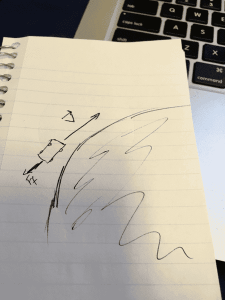

Two questions I had:
1. How is the force of friction of the tires pointed inwards to cause centripetal acceleration? If the tire is rotated when trying to turn, the car is still traveling with a velocity perpendicular to the circle and force of friction would still be counteracting the direction of movement?
2. How can gravity = centripetal acceleration at the top of loop de loop? They are pointed in same direction downward? Also i have been told that normal force is zero when centripetal acceleration = gravity. If normal force is zero, the car wouldn’t be in contact with the road then and would fall? Second, I was told that normal force increases as centripetal acceleration increases. However, isn’t normal force pointing downward toward the center counteracting the car pushing on the road upward? But also if gravity is pointing downward, how is the car even exerting force on the road upward? To me it seems all the forces are pointed in the downward direction at the top of the loop.
centripetal force is a center seeking force and is not a force of its own, rather, it is the net force acting toward the center. For the car in a circle on a level road, the centripetal force is the net force toward the center, and the only force toward the center is friction. The car has a tendency to move outward, so friction is opposite the pending relative motion, thus, inward.
gravityfirce is one of the forces causing centripetal acceleration , and the other is the normal force. At the top, Net force must always be down in the direction of the downward inward acceleration.
when gravity is the only force causing the acceleration, the normal force is a hair above zero at the critical speed . It doesn't fall unless the speed at the top is less than the critical speed.
yes, normal force increases and points down in same direction as gravity force, increasing the net force and centripetal acceleration downward, and the speed.

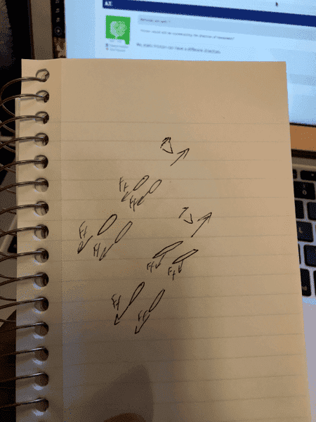

A.T. said:
No, static friction can have a different direction.Draw a free body diagram.
These are the diagrams I had?

Abhishek Jain said:
Also I am having trouble understand what is exactly keeping the car in contact with the road in the loop de loop.
The curvature of the loop is stronger than the curvature of the free fall parabola it would take without the loop, so the road is in it's way.
