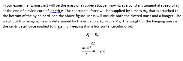

I was wondering how increasing the mass at the bottom would influence the time taken for the object to complete 10 revolutions, my hypothesis was that it would decrease in an inverse ration manner of which I am still trying the find mathematically[/B]
I understand that the centripetal force is F=mv^2/r
And the V=d/t = 2(pi)r/t
therefore the equation is
F=m(2(pi)r/t)^2 all divded by radius
The
mass m1 will be the mass of a rubber stopper moving at a constant tangential speed of athttps://www.physicsforums.com/file:///C:/Users/RICHER~1/AppData/Local/Temp/msohtmlclip1/01/clip_image002.png the end of a nylon cord of length.https://www.physicsforums.com/file:///C:/Users/RICHER~1/AppData/Local/Temp/msohtmlclip1/01/clip_image004.png The centripetal force will be supplied by a mass thathttps://www.physicsforums.com/file:///C:/Users/RICHER~1/AppData/Local/Temp/msohtmlclip1/01/clip_image006.png is attached to the bottom of the nylon cord. See the above figure. Mass will include both the slotted mass and a hanger. The weight of this hanging mass is determined by the equation:https://www.physicsforums.com/file:///C:/Users/RICHER~1/AppData/Local/Temp/msohtmlclip1/01/clip_image008.png The weight of the hanging mass is the centripetal force applied to the mass https://www.physicsforums.com/file:///C:/Users/RICHER~1/AppData/Local/Temp/msohtmlclip1/01/clip_image010.png, keeping it in a horizontal circular orbit.
or
https://www.physicsforums.com/file:///C:/Users/RICHER~1/AppData/Local/Temp/msohtmlclip1/01/clip_image014.png
the final result in terms of T period was
I'm not sure if this relationship is inverse manner and whether it is mathematically correct.
Any help would be appreciated!

There is an error in the text in capture12. It says the weight of the hanging mass equals the centripetal force. What has been overlooked?
Is the tension of the string that is being overlooked as that also is a contributing factor to the centripetal force?

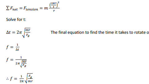

My teacher gave me this hint but I'm not sure what the lowercase f stands for
See capture13 below
He said to Linearizing the equation, from this I was guessing that I would get a logarithmic function
See capture13 below
f stands for frequency here, but capture13 makes the same error as capture12, and others beside.
First, ΣFnet makes no sense. Fnet is the sum of forces, so ΣF=Fnet.
Secondly, Fnet is not the tension; there is also gravity.
The blunder capture12 and capture13 make is that they ignore the angle.
If T is the tension, can you write the expressions for the vertical sum of forces and the horizontal sum of forces?
