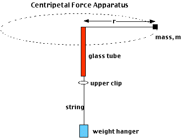

I have a graph with the radius on the x-axis and Fc on the y axis. I had to then calculate the slope of this linear relationship. I did that, and I got 0.17.
The problem is that I don't know what this represents. mass? acceleration??
Fc = m4π^2rf^2
btw π = pi = 3.14
I tried to isolate for the slope of the line, which would be making the left side equal to Fc/r.
This is what I got:
Fc/r = m4πf^2
I know that [STRIKE]Fc[/STRIKE] mass is kept constant.. then I have no idea where to go from there :S

Okay, so the slope equals [itex]4 \pi^2 m f^2[/itex]. If you know m and the value of the slope, you can calculate what the constant f is. Or, if you know f and the slope, you can calculate what m is. But -- was frequency f really a constant throughout your experiment?
By the way, does your lab apparatus resemble something like the following?
Redbelly98 said:
Welcome back to PF.Okay, so the slope equals [itex]4 \pi^2 m f^2[/itex]. If you know m and the value of the slope, you can calculate what the constant f is. Or, if you know f and the slope, you can calculate what m is. But -- was frequency f really a constant throughout your experiment?
frequency f was not constant. The only constant values were Fc (centripetal force), which was 0.5N, and mass, which was 0.03kg.
are you saying that I can't use the equation if f isn't constant?
Yes, it is similar.

Something is wrong here. If Fc is constant, and you plot it on the y-axis, you should get a horizontal line, so slope=0.
It looks like the variables here are f and r, so the graph should involve those quantities instead. But, just graphing f vs. r will not give a straight line. Did you get any instruction in what you are supposed to actually graph?

This was similar to our procedure starting on page 4: http://schools.hwdsb.on.ca/highland/files/2011/01/centripetal_force.pdf
So basically the question I'm trying to answer now is #23.
The graph of radius and Fc was made after doing #20 and #21 in the PDF. The values of Fc were extrapolated from a graph of f^2 on the x-axis and Fc on the y axis, seen in #20.
Got it.
Looks like you have already seen that the graph is linear or a direct proportion, and that the slope should equal [itex]4 \pi^2 m f^2[/itex]. You can measure the slope from your graph and, since you know m and f, compare the measured-from-the-graph slope value with what you get by calculating [itex]4 \pi^2 m f^2[/itex].
