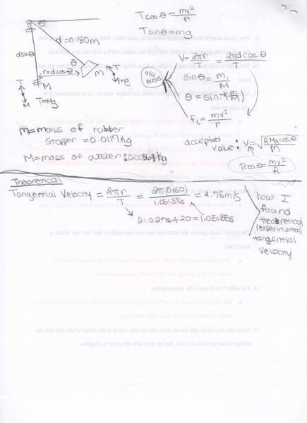

Hi! I need help and please do not delete this! What I need help with i cannot put into the template provided. I am sorry but I need help with a lab report. PLEASE I AM BEGGING YOU TO NOT DELETE THIS BECAUSE IT DOES NOT FOLLOW THE TEMPLATE! I REALLY REALLY NEED HELP!
I need to find the accepted values and percent errors for the velocity and I don't know what else. I have the theoretical values. My teacher gave us a bunch of equations in class but I don't know what they go with. I attempted to attach the lab and the equations from class because I thought it would be easier. I REALLY need help! Let me know if the attachments don't work!

Check your derivation of the "accepted value" formula. You have T*sin(θ) = mg and T*cos(θ) = mv²/r. When I solve the first for T and sub into the second, I get v = square root of rg/tan(θ) rather than your cos(θ).

So v = sqrt[rg/tan(θ)] if I haven't bungled the derivation. It should be easy to work out those if you have the r and θ values. What do you mean by "percent errors"? Do you mean the difference between the v = sqrt[rg/tan(θ)] and the v = 2πr/T values calculated from your time measurements? What trouble are you having in working these out? As for whether the errors are "reasonable", that would depend on how accurately the measurements were made. Did you happen to repeat one of the trials and get slightly different results? I think the angle measurement is the cause of most of the error because it is so difficult to measure - you might estimate how accurately you measured the angle and calculate how much that changes the v = sqrt[rg/tan(θ)].

I was told d = 0.80m and we have to find [itex]\theta[/itex].
All of the equations were ones my teacher gave in class, so I do not know where he got cos[itex]\theta[/itex]. For percent error, I mean [itex]\left\|[/itex] (theoritcal velocity - actual velocity) / actual velocity [itex]\right\|[/itex] X 100. I do not know if if use 2[itex]\pi[/itex]dcos.[itex]\theta[/itex]/T or [itex]\sqrt{(RMgcos\theta)/m}[/itex]. I am also unsure if I should use the equation [itex]\theta [/itex] = sin[itex]^{-1}[/itex] (m/M) to find [itex]\theta[/itex].
The first document I attached had the diagram my teacher gave to me on it. He said r=dcos[itex]\theta[/itex]. d = 0.08m, and I do not know how to find [itex]\theta[/itex].

I don't like the words "theoretical" and "actual" but it is clear you are to find the per cent difference between the v calculated using the measured period and the v calculated from the mass, angle and radius.
The big problem is you didn't measure the angle, which is needed for those calculations. No fair calculating the angle from an assumption that the two v's should be identical. A real scientist would run the experiment again, devising a clever way to measure the angle as accurately as possible. The usual method is to run the experiment in front of a white board or wall with a bright light in front to cast a shadow of the apparatus on the board. You can mark an angle scale on the board ahead of time or mark the spots where the shadows of the bob and glass tube are, then measure the angle after the run.
Think about it - any tube or pipe will do, so you could easily do the experiment again at home. It will go very easily and quickly the second time and you will have complete and better data.
what would I use v = [itex]\sqrt{(RMgcos\theta)/m}[/itex] for?
That would be your "theoretical" velocity calculation. You can't do it because you didn't measure θ in the experiment. Note: I think it should be v = sqrt[rg/tan(θ)]. I don't understand why you have two different m's in your expression.
