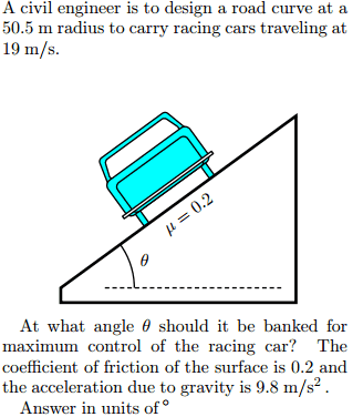

In summary, the homework statement states that if a car is 50.5 meters in radius and 19 meters per second in speed, then its acceleration due to gravity is 9.8 meters per second squared. Additionally, at an angle of 82.25 degrees, the car should be banked at its maximum angle to control its speed.
spartacus
50.5 m radius
19 m/s speed
µ = 0.2
acceleration due to gravity is 9.8 m/s2
At what angle θ should it be banked for
maximum control of the racing car?
sum of total forces=0?
N*cosθ=mg
N*sinθ-mgµ=(mv^2)/r
mg*tanθ-mgµ=(mv^2)/r
tanθ-µ=v^2/r
θ=arc tan((v^2/r)+µ)
θ=82.25 degrees?
I feel like i did everything right, seems high though...

Because it asks for the angle of 'maximum control'. Is this question a part of a multi-part question?

Are you assuming that friction acts horizontally?

I believe the question means maximum control on the road that has the coefficient of friction of .2 or else why would mu be provided
and yes
Please don't give up on me, i easily did the other questions from this problem set, this question shouldn't be too hard, i just don't know what i did wrong

Note that when you consider friction, you have a range of acceptable speeds. Friction will give you the maximum and minimum values of the speeds that can be maintained without slipping. I would interpret the angle of maximum control to be that angle where friction is not needed.
The problem could just be poorly constructed. Are you posting the complete problem, word for word?

That is incorrect. Friction acts parallel to the surface.

i have it right here let ill upload a screenshot
It's a bit perplexing as to what they mean by 'maximum control'. I would interpret it as the angle that requires no friction.
Is this from some textbook?
No, it's an online assignment
The way i solved it, i just used the data to find which angle it would be at that speed
If you're going to apply friction, realize that the maximum value is given by ##\mu N## and that it acts parallel to the surface, not horizontally. And it could act up the incline or down the incline, depending on the angle.

If it's parallel should i use mu*mg sintheta then because that would make the problem a lot more difficult

It seems like a poorly worded problem to me.
The normal force does not equal mg.
I would solve the problem assuming no friction. Perhaps they are just messing with your head to see if you know what matters and what doesn't. ;)

i mean having Ncostheta=mg for the vertical and Nsintheta-mu*mg*sintheta=(mv^2)/r for horizontal

Two problems. Since friction has both vertical and horizontal components, your first equation would have to be modified. And, once again, the normal force does not equal mg.
