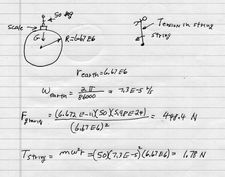

I am confused. See my diagram below. With the Earth rotating, I think the scale would read the force of gravity or 448.4 N. If the Earth were not rotating, would the scale read less or more due to the effect of centripetal force? I tend to think more by an amount of 1.78 N. Is this correct?
If there were no Earth, and the 50 kg person was rotating around a point the centripetal force should be 1.78N. So how does the centripetal force add or subtract from gravity.
The weight shown by the scale is the force from the person on the scale. There are two forces acting on the person, the gravitational force and the force from the scale on the person. These need to add up (vectorially) to the centripetal force needed to maintain the person in circular motion. Draw a free body diagram with the forces and consider that the force resultant needs to be 1.78 N towards the center of the Earth.

The answer is yes and it would make the scale reading 1.78N smaller than the real weight. Just do as @Orodruin says to understand why. All I have to add to post #2 is that
(force from scale to person)=-(force from person to scale)
due to Newtons 3rd law of mechanics.
The force from the scale to person is part of the centripetal force. The force from the person to the scale is what the scale reading shows (in absolute value).

No. Centripetal force is not an applied force. Adding up all the applied forces (in this case, gravity and the reaction from the scale) produces the net force. We can choose to resolve the net force into a component collinear with the velocity and a component normal to it. Centripetal force is just the name we give to the normal component.
Confusion arises because of the way we think about cause and effect here. As described above, the reduced scale reaction results in the centripetal acceleration. Yet it seems more natural to say that the spin of the Earth results in the acceleration and hence the reduced scale reaction.
The reaction force between two solid bodies in contact is the minimum magnitude force that prevents interpenetration. The spin of the Earth allows you to accelerate towards its axis to some extent without breaking the scale. Hence the reaction force reduces exactly so as to produce the appropriate centripetal acceleration.

Hi. It might be worth adding these points...
1. Just in case there is any possibility of a misunderstanding, note that in the Post #1 diagram, the 50kg person is shown on ‘top’ of the Earth. This might imply that the person is at the North Pole (rather than at the equator say).
If at the North (or South) Pole, the person is on the axis of rotation, so their distance from the centre of rotation is r=0. The person’s centre of mass is not then rotating. This would mean ω²r = 0 and there is zero centripetal force associated with the earth’s rotation.
It would be clearer to show the person on the ‘side’ (at the equator), if that is what is intended.
2. The wrong value is used for the earth’s radius. Post #1 states R = 6.67E6 (with no units!). In fact the approximate equatorial radius is 6.38x10⁶ m (and the polar radius is 6.36x10⁶m). Looks like the value for R has been muddled with the value for the gravitational constant (G).
The centripetal force for a 50kg mass at the equator is then:
##m \omega ^2 r = 50 \times (\frac {2\pi}{86400})^2 \times 6.38 \times 10⁶ = 1.69##N (not 1.78N)
Therefore, depending on the person’s latitude, the centripetal force can be anywhere between 0 and 1.69N.
3. I’d like to add that the term ‘centripetal force’ is simply an alternative name for whatever force is perpendicular to an object’s velocity. This means that for constant speed circular motion, ‘centripetal force’ is basically just another name for the resultant force.
4. Centrifugal force is a useful concept if used properly. Centrifugal force is a fictitious force that appears to exist in a rotating frame of reference. Think of a car turning a tight bend. Inside the car you experience being forced sideways. The apparent sideways force is called centrifugal force. It is the result of you tending to go in a straight line (Newton’s 1st law) while the car changes direction. The loss of weight due to the earth’s rotation is centrifugal force.
