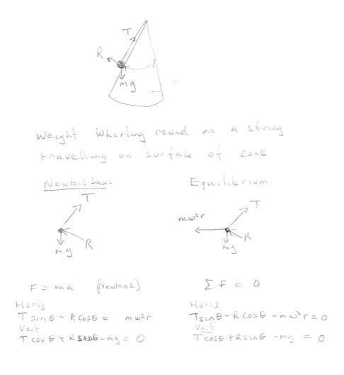

Now for centripetal force, this is always provided by the normal suppliers or agent of force.
So for instance consider a weight whirling round on a string.
The centripetal force is provided by the tension in the string - they are one and the same.
However the weight is also in constant acceleration.
This acceleration is directed towards the centre of of rotation (inwards).
This is in accordance with Newtons second law force = mass times acceleration.
So the weight is not in equilibrium.
This is so fundamental and important I will repeat it
Shazam ! * # ! Enter the centrifugal force!
This ficticious force is exactly equal in magnitude to but opposite in direction to the centripetal force.
Let us pretend that such a force is acting on the weight.
Now the weight is in equilibrium Yay!
The weight is said to be in equilibrium under the action of the tension in the string and the opposing centrifugal force.
This trick or transformation was first proposed by D'Alembert.
It enables us to reduce a problem in dynamics ( using Newtons Laws of motion) to a simpler one in statics (using the laws of equilibrium).
Note that you never see both the centripetal force and the centrifugal force appear in the same analysis you see either one or the other.
When the centrifugal force is used the acceleration is zero, since the system is in equilibrium.
When the centripetal force is invoked the system is not in equilibrium but accelerates. This acceleration is provided by the centripetal force.
So as regards gravity and acceleration, the acceleration due to gravity = the centripetal acceleration or the force of gravity = the centripetal force. Here '= ' means the same as.
Gravity and the centripetal force (acceleration) are not additional, they are one and the same.
Does this help?

In the attachment I have shown the analysis of a mass m hanging by a string on the side of a cone of angle θ, and whirling round it.
I have done this for both the dynamic and static analysis methods which obviously must yield the same result, but in this case can be seen to have the same equations as well.
Note the difference between the dynamic (Newton) analysis and the static analysis after introducing the ficticious centrifugal force mrω2 to create equilibrium.
The circular motion is in a horizontal plane parallel to the base of the cone and has radius r.
The centripetal force providing a rightwards acceleration towards the vertical axis of the cone is the resultant of the resultant of the horizontal components of the real forces being the normal reation at the cone surface and the string tension. This is a real resultant providing a real acceleration.
In the first analysis we equate this acceleration to the mass times the force.
In the second we counter it with an equilibrating centrifugal force.
