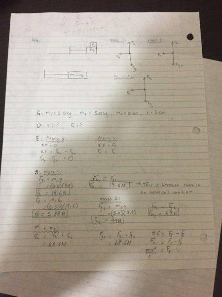

Mass 1 (2.0kg) sits on top of mass 2(5.0kg), which rests on a frictionless surface. The coefficient of static friction between mass 1 and mass 2 is 0.30. A string of length 5.0m is tied to mass 2, and both masses are swung around in a horizontal circle. Calculate:
a) The maximum speed of the masses
b) The tension in the string
Fc= mv^2/r
I assumed that since there is no vertical motion, the Fc would be the tension in the string. So, i added both masses to make a system diagram of one block with both masses. Then, when I tried to solve for the maximum speed, I was stuck with 2 unknowns, Fc, and Ftension. I think we should make two equations and subsitute into the other and solve for one variable, but I am not sure.
Can someone please help me, and work through this problem with me?

Show us the work you described in your opening post.

how do i show it? like post a picture?
You could either post a picture or type it.

I posted a picture
ImpulseLeaq said:
so basically i would calculate force of friction of the upper block, and use that to calculate the tension of the string in the bottom block?
Yes. Give that a go.
The two blocks are capable of moving independently, so you can obtain equations for the forces on each. If you treat them as a single unit only then you are denying yourself enough equations.
Let's start by looking at what you did for the composite body of mass ##m_1+m_2##. In your first post you said you had two equations, but were stuck with two unknowns, ##F_c## and ##F_T##, but for this composite body those two forces are actually not any different. ##F_T## is the centripetal force. So the last equation on your paper is
##F_T=\displaystyle \frac{mv^2}{r}##,
where ##m## is the mass of the composite body.
Now do the same thing for the upper body.
Let's review the process:
Start with Newton's Second Law: ##F_{net}=ma##,
where ##F_{net}## is the net force exerted on some object,
##m## is the mass of that object, and
##a## is the acceleration of that object.
You need to first understand that process for the composite body, and then again for the upper body. That will give you your solution.
