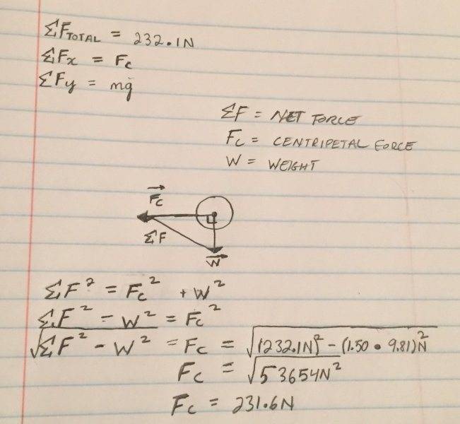

Here is my attempt at solving for the centripetal force. I don't think its correct but it's all I know how to do
How come your force balance equations don't have the components of the spring force acting on the mass in the horizontal and vertical directions?
Chet

I thought that the spring force is the net force? That's how I was able to find the net force. Please clarify
It would be wise to see Fc as a resultant force, i.e. the net force. It is the sum of the two forces that work on the mass: one from gravity, the other from the spring.
The resultant force is what makes the mass follow a circular trajectory.
You calculate its magnitude (you need that for B.), but in A) the exercise asks for an angle...
The spring force is not the net force. The net force is the vector sum of the spring force and the weight. Now please, write out the force balances in the horizontal and vertical directions in terms of the horizontal and vertical components of the spring force, and the weight of the mass.

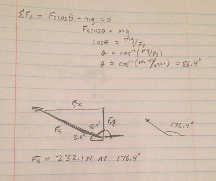

Something else needs to be known.
The sum of forces in the y direction must be 0 so that we can have an equation.
(Fs means force of spring)
ΣFy = Fscosθ - mg
ΣFx =Fssinθ
If the sum of forces in the y direction = 0 then we have our equation. Otherwise i don't kneo

Well, then you have your equation for the y direction. That gives you theta.
What is your force balance equation for the x direction?
Chet

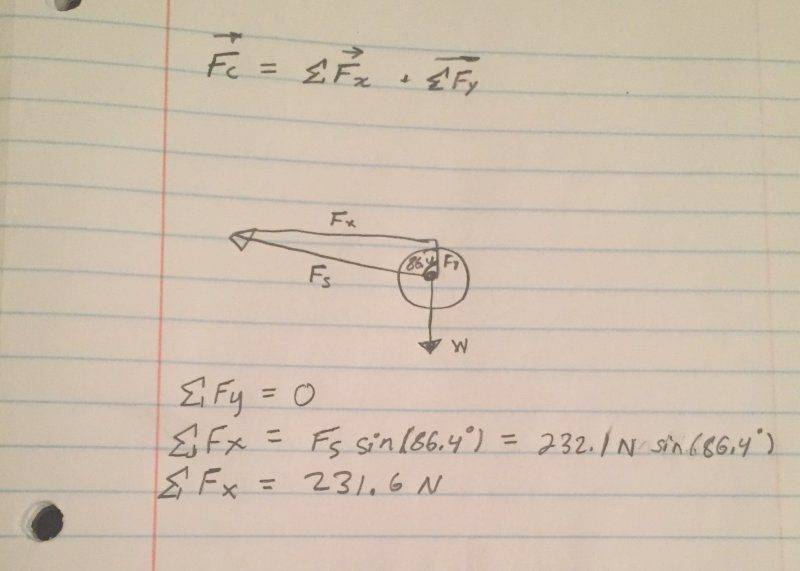

First attachment is solving for the angle which I found to be 86.4 degrees. (It really doesn't look that way in the picture I hope I didn't do it wrong). Second attachment is the sum of forces in direction x which is also the magnitude of the centripital force
Looks good. Now on to b) and c) ?
