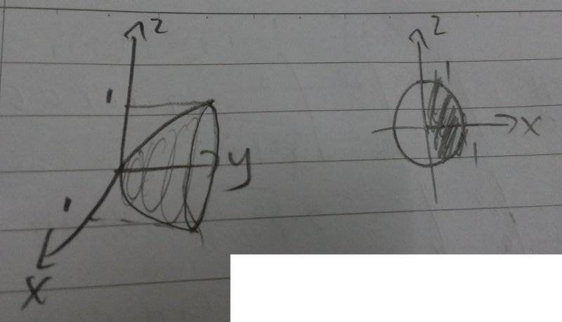

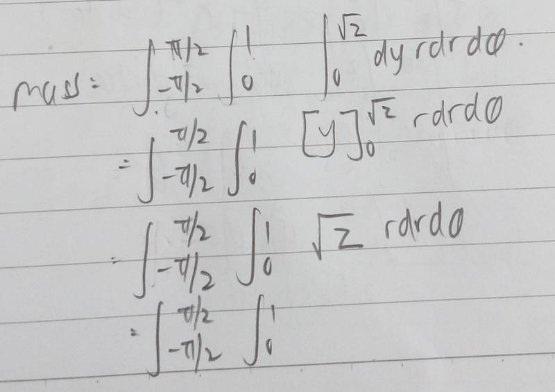

Find the centroid of solid enclosed by surface z= y^2 , plane x=0 , x = 1 and z =1 . The density is 1
Here's my working .
Centoird = mass of inertia / mass
So , i find the mass first .
It's clear that the circle is on zx plane ... I am not sure whether to use z= rcos theta or z = rsin theta . Can you help ?
Here's my working .
Almost everything you have here is wrong.
  • Your drawing is way off. Take more time and get a more careful drawing the represents the solid described in your problem statement.
  • "the circle is on zx plane" -- No, it's not a circle.
  • You are apparently trying to use polar coordinates -- why?
