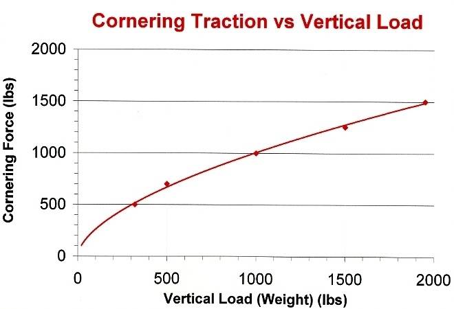

I'm with cjl, the end with more weight should breakaway first. Here's a typical graph for the available lateral force vs the vertical load on a tire:

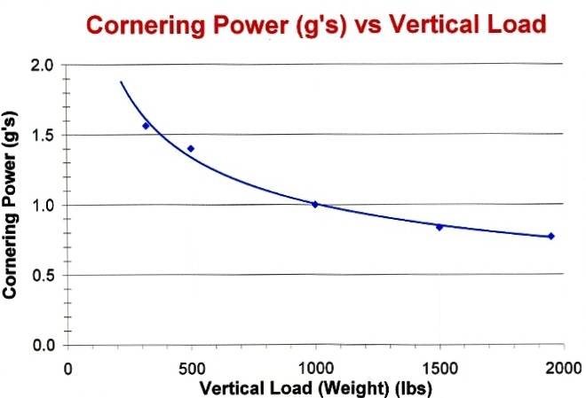

Here are the same data, but now it's the coefficient of friction of the tire (i.e. the cornering force divided by the vertical load) vs the vertical load:
515661d1256951859-losi-xxx-s-tips-tricks-open-mod-etc-graph-cornering-gs-vs-vertical-load001.jpg
We can see that a tire with less weight on it has a higher coefficient of friction and thus can support greater lateral accelerations.
For example, with the previous tire on all corners of a 3000 lb car, with 750 lb on each corner the car would be able to sustain 1.2 g of lateral acceleration. With 2 front tires with 500 lb each and 2 rear tires with 1000 lb each, the front end would be able to hold until 1.4 g, but the rear end would loose it at 1.0 g.
Worst, if we assume there is a total weight transfer (all the weight on the outside wheels), the front outside wheel has 1000 lb (1.0 g) and the rear outside wheel, with 2000 lb on it, will hold until only 0.75 g. But if you tuned your suspension to transfer weight from the rear end to the front, you could have 1500 lb on each outside tire, giving you a 0.8 g limit back and front.
