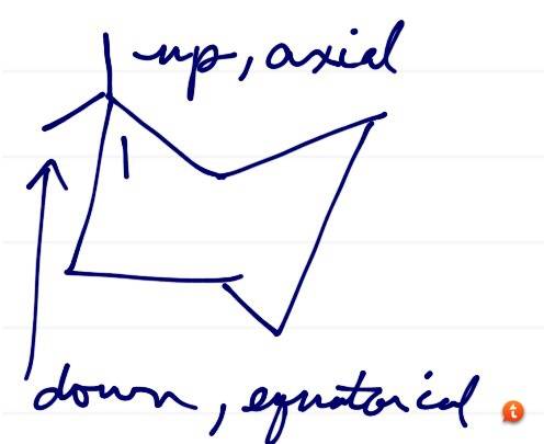

Are these structures equivalent? Here's the professor's rendering:
http://i.minus.com/jnojtCx6wYvqD.png
Here's my rendering. The molecule is 1-chloro-2-ethylcyclohexane.
I had projected the chlorine out of the page and the ethyl group into the page (opposite of the prof's rendering). And since the chloro is on the first carbon, and in my chair conformation, there are only two possible positions for any attachment to the first carbon - axial up or equatorial down - I made the chlorine axial up (because it's also up in the 2D drawing I made). Similarly, I made the ethyl group axial down (because it's projected into the page according to my 2D drawing, and the alternative is making it equatorial up, which doesn't match my 2D drawing).
Is my reasoning correct and is my drawing ultimately correct?
Here's my drawing.

Probably still know more orgo than I do! So would it be correct to say that for each position on the cyclohexane chair conformation, there are one of two choices - up or down?
I ask because this is the process I have for converting between 2D projections and 3D conformations:
1) Number the carbons correctly (according to nomenclature rules).
2) Wedge: coming out the page. Up. So choose make that substituent up (be it equatorial up or axial up; doesn't matter - everything's relative). But since each carbon has only two "options" - i.e the first carbon above only has the option of having an axial up substituent or an equatorial down substituent, I just have to match the orientation).
3) Dash - going away from me (going into the page). Down. Make this substituent down (be it axial down or equatorial down).
Also are these directions alternating - i.e. one up and one down - because the angle between the substituents is about 109.5 degrees? I think I remember my book saying that the actual angle is 110.9 degrees (some compromise between angle and torsional strain).
Yes.
Assuming you are handling "cyclohexane", you are correct.

"Are these directions alternating" - Are you referring to the adjacent carbons?
I mean the hydrogens or whatever substituents on the carbons - are they alternating up / down because of the angle between the attachments on the carbon?
And you mentioned the reason for your conclusion being the bond angle. All the substituents can be up or down.
(I think I saw Hexachlorobenzene that way), but that would cause a little bit of torsional strain I suppose.
True, all the substituents can be up or down but only on certain carbons are there say axial up positions. I.e. None of the carbons on the bottom of the chair would have axial up positions except the middle one.
