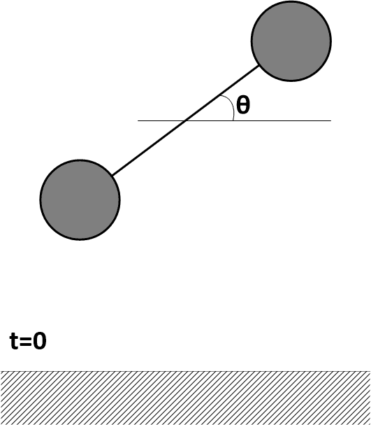

Two material points of identical mass are in free fall, connected by a rigid rod of negligible mass and length ##L##. At time ##t=0## both masses have zero initial velocity and are positioned at different heights above the ground, the rod forming an angle ##\theta## with the horizontal. Determine how the system moves immediately after the first contact with the ground, imagining that the ground is perfectly smooth and assuming a fully elastic collision model for the impact.

I like to sketch situations and at ##t=0## I get something like this
with the annotation that the two masses are considered point masses.
If the center of mass at ##t=0## is at height ##h_0##, then one mass point is at ##h_0 - \frac{L}{2}\sin\theta## and the other is at ##h_0 + \frac{L}{2}\sin\theta##.
With the relevant equation for free fall we can calculate that the lower mass will hit the floor at ##t_{1}= \sqrt{ {2\over g} \left (h_0 - \frac{L}{2}\sin\theta\right )}##. Both masses move downwards with a speed ##g\,t_{1}##.
The elastic collision with the floor will instantaneously change the direction of the velocity of the lower mass. So the situation at ##t_{1}## before and after the collision is like
And the center of mass is at a standstill at that instant . From then on the contraption is rotating while also dropping further. The next point in time that is of interest is when the other mass hits the floor; call that ##t_{2-}##.

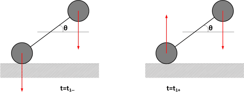

I tried to draw it
without calculating. Features are:
  • The center of mass is a bit lower than at ##t_{1}##, so ##\theta' < \theta##
  • mass on the left vertical speed is smaller, right one higher
Now the right mass velocity changes sign, and the center of mass will go up again.
Since there is no loss of mechanical energy, I suspect we will come back to the situation at ##t=0## but I have hard time believing that. So if someone could shed some light on this, that would be great.
I do wonder what exactly the exercise composer has in mind: the scenario up to the second mass hitting the floor ? Qualitatively only ?

You can't treat the two masses independently during the bounce. There will be a simultaneous impulse along the rod, changing both velocities.

Would my ##t=t_{1+}## picture be a good starting point ?
BvU said:
Would my t=t1+ picture be a good starting point ?
No, because it shows both velocities as purely vertical. I considered the vertical velocity of the mass centre and the angular velocity.

Right.
pepos04 said:
To post a solution is to explain how the system moves immediately after the collision, ….
Since the potential energy depends on the height of the masses, we can write: $$PE = mg(h_A +h_B)$$
There is no change in PE from immediately before impact to immediately afterwards, so there is no need to consider this.
pepos04 said:
Since the energy is conserved, we can equate the initial and final energies of the system. We can write: $$m g (h_A + h_B) = \frac{1}{2} m (v_A^2 + v_B^2) + \frac{1}{2} I \omega^2$$
The initial energy is the KE just before impact, ##mv_0^2##. Equate this to the KE after impact.
Also, your KE after impact expression is wrong. If you want to express the motion after impact in terms of the two velocities, then that is the whole KE, ##\frac{1}{2} m (v_A^2 + v_B^2)##. There is no additional energy from rotation.
But you will find it easier to work in terms of the system considered as a rigid body, so express the motion in terms of the velocity of the mass centre, ##v_1##, and rotation about that centre.
There were a lot of errors in your LaTeX. Before posting a reply with LaTeX in it, check the LaTeX by clicking the "magnifying glass on paper" icon at the right hand end of the toolbar above the text input area. Sometimes it doesn’t work and you have to do a screen refresh and try again. It is a toggle, so click it again to get back into edit mode.
OK, I will try to write a procedure following your advice. However, is it correct to say that the mass hitting the ground cannot receive a reaction with a horizontal component because the ground is smooth and its impact is perpendicular to it? Then, it should be repelled along the vertical with velocity ##v_0 =\sqrt{2gh}##. This means that the other suspended mass should move perpendicular to the rod by deviating from the vertical fall, making an instantaneous rotation around the other and forming an angle ##\theta## with the vertical. Since its angular momentum before the collision was ##Lm\sqrt{2gh}\cos \theta##, it should also be ##Lm v \cos\theta## immediately after the collision, i.e. the modulus of ##v## should also remain ##v_0##, and thus only change direction. Please I would like to know if I am on the right track or is this nonsense? Thank you.
Yes, there cannot be a horizontal reaction from the ground.
No, because at the same time as the reaction from the ground there is a reaction along the rod. This exerts a horizontal impulse equally and oppositely on the two masses, giving them equal and opposite horizontal velocities.
Likewise, it exerts a vertical impulse equally and oppositely on the two masses. That increases the vertical impulse from the ground.
It's this messiness that means it is much simpler to work in terms of conservation laws than worry about all the forces.
Likes BvU
haruspex said:
Yes, there cannot be a horizontal reaction from the ground. No, because at the same time as the reaction from the ground there is a reaction along the rod. This exerts a horizontal impulse equally and oppositely on the two masses, giving them equal and opposite horizontal velocities. Likewise, it exerts a vertical impulse equally and oppositely on the two masses. That increases the vertical impulse from the ground. It's this messiness that means it is much simpler to work in terms of conservation laws than worry about all the forces.
OK, let me see if I understand. The rod holding the two masses together exerts a force to force them to stay ##L## apart. This force has a horizontal component. In the motion I described, there was a horizontal force acting on the second mass, because now its velocity is no longer vertical. But by the principle of action and reaction, then a horizontal force must also act on the first mass. Right? Would that be equivalent to saying that there are no horizontal forces external to the mass-rod-mass system, but in the description of the motion, the horizontal momentum has changed?
Right
The horizontal momentum of the mass-rod-mass system has not changed. It is still zero.
haruspex said:
Right The horizontal momentum of the mass-rod-mass system has not changed. It is still zero.
For “horizontal momentum” I mean “linear momentum”. Could you please explain this point more? However, I tried to work out a procedure under your previous advice, but some points I could not apply (for example, the assertion: "there is no additional energy from rotation," connected with "express the motion in terms of the velocity of the mass center ##v## and rotation about that center") Let me know if the process convinces you, what to fix, what to change altogether, etc. Let’s start ● ##m##isthemassofeachpoint ● ##L##isthelength of the rod ● ##\theta## is the angle of the rod with the horizontal before impact ● ##u##isthevelocity of each point before impact ● ##v##isthevertical velocity of the center of mass after impact ● ##\omega##istheangular velocity of the system after impact ● ##J##istheimpulse from the ground ● ##P##isthepoint of impact ● ##R##isthedistance from the center of mass to the point of impact ● ##I##isthemomentofinertia of the system about the center of mass ● ##g##istheacceleration due to gravity ● ##h##istheinitial height of the lower point above the ground As wesaid, we assume that the system is a rigid body of mass ##2m## and that the collision is fully elastic. Since the system is in free fall, we can use the equation of motion for constant acceleration to find the velocity ##u## before impact: ##u =\sqrt{2 g h}## I applied the conservation of energy. The system has only kinetic energy before and after impact, so we can write: $$\frac{1}{2} (2m) u^2 = \frac{1}{2} (2m) v^2 + \frac{1}{2} I \omega^2$$. Simplifying and rearranging, we get: $$v^2 + \frac{I}{2m} \omega^2 = u^2$$. I also applied the conservation of angular momentum. We choose the point of impact ##P## as the axis of rotation, since there is no external torque about this point. The angular momentum of the system before impact is:
$$L_p = R (2m) u$$. The angular momentum of the system after impact is: $$L_p = I \omega$$. Equating these two expressions, we get: $$\omega = \frac{R (2m) u}{I}$$ I should find the values of ##R## and ##I##. I used the geometry of the system to f ind ##R##: ##R =L\sin \theta##. I used the parallel axis theorem to find ##I##: $$I = 2 (mL^2/12+mR^2)$$. Substituting these values into the previous equations, we get: $$v^2 + \frac{m L^2}{6} \omega^2 = u^2$$, and $$\omega = \frac{2 u \sin \theta}{L}$$. Wecansolve for ##v## and ##\omega##. We can eliminate ##\omega## from the f irst equation by using the second equation: $$v^2 + \frac{2 m u^2 \sin^2 \theta}{3} = u^2$$. Solving for ##v##, we get: $$v = \sqrt{u^2- \frac{2 m u^2 \sin^2 \theta}{3}}$$. Substituting this value into the second equation, we get: $$\omega = \frac{2 u \sin \theta}{L} \sqrt{1- \frac{2 m \sin^2 \theta}{3}}$$. To summarize, I obtained: ● Thecenter of massofthe system moves vertically downward with a velocity $$v = \sqrt{u^2- \frac{2 m u^2 \sin^2 \theta}{3}}$$. ● Thesystemrotates clockwise about the point of impact with an angular velocity $$\omega = \frac{2 u \sin \theta}{L} \sqrt{1- \frac{2 m \sin^2 \theta}{3}}$$.
You can either write the KE treating the masses as independent, ##\frac 12mv_a^2+\frac 12mv_b^2##, or treating them as a single rigid body, ##\frac 12(2m)v^2+\frac 12I\omega^2##. For simplicity, l will use ##r=L/2##.
Since ##v_a^2=(v+r\omega\sin(\theta))^2+(r\omega\cos(\theta))^2##, ##v_b^2=(v-r\omega\sin(\theta))^2+(r\omega\cos(\theta))^2##, and ##I=2mr^2## these two forms are equivalent.
What you had done previously is mix them as ##\frac 12mv_a^2+\frac 12mv_b^2+\frac 12I\omega^2##, thereby counting rotational energy twice.
Two problems there: ##\theta## is the angle to the horizontal, so you need cos for horizontal displacement, and it is only L/2.
I is the moment of inertia about the mass centre of the system, so no need for the parallel axis theorem.
And these are two point masses at the ends of a light rod, not a rod of uniform mass. Each mass has MoI of ##m(L/2)^2## about their common centre, for a total ##\frac 12mL^2##.
Fix up those points and try again.
  • #31
OK@haruspex, thanks. I'll try again. From conservation of angular momentum: $$2m \left(\frac{L}{2}\right) \cos \theta u = I \omega$$, with ##I = \frac{1}{2}mL^2##. So: $$2m u L \cos \theta = m \omega L^2 \Rightarrow \ \omega = 2 \frac{u}{L} \cos \theta = 2 \frac{\sqrt{2gh}}{L} \cos \theta$$. From conservation of mechanical energy: $$\frac{1}{2} (2m) u^2 = \frac{1}{2} (2m) v^2 + \frac{1}{2} I \omega^2 \Rightarrow \ 2 m u^2 = 2 mv^2+\frac{1}{2}mL^2 \Rightarrow \ 4 u^2 = 4 v^2 + L^2 \omega^2$$. Plugging in ##\omega = 2 \frac{u}{L} \cos \theta##, we get: $$4 u^2 = 4 v^2 + L^2 \left(4 \frac{u^2}{L^2} \cos^2 \theta \right) \Rightarrow \ v^2 = u^2- u^2 \cos^2 \theta \Rightarrow \ v = u \sin \theta = \sqrt{2gh} \sin \theta$$. Correct? Or are there fallacies in it?
I am also undecided about the sign, and I am not very clear about the graphic representation. Could you tell me how to do it? I have another doubt, though. The text asks to determine how the system moves immediately after the left mass is impacted. Then, the right mass assumes a direction perpendicular to ##L## with magnitude ##\sqrt{2gh}## unchanged with horizontal component ##\sqrt{2gh} \sin \theta## and vertical component ##-\sqrt{2gh} \cos\theta## while the other mass also assumes the same components with reversed sign. Overall after the collision, the total momentum of the system is therefore zero.
The rigid rod rotates around the CM tending to the horizontal position, and by the conservation of mechanical energy the left mass should reach position ##h## when the right one hits the ground. Probably, however, this solution does not work for ##\theta=\pi/2## since the horizontal component of ##v## cannot be ##v## itself and the vertical one null. The opposite should be true. Can this solution hold if supplemented with the condition ##\theta \neq \pi/2##, while for ##\theta =\pi/2##, ##v## and ##L## are vertical and aligned, the angular momentum is conserved, equal to zero before and after the impact of a mass that remains unchanged, and by conservation of energy the CM starts and returns to the same altitude h? Does that description fit, or are there fallacies?
Perhaps on second thought, this solution conserves energy and horizontal momentum, and meets the condition that the two masses remain at distance L. But I think there are infinite solutions that satisfy these 3 conditions. We have 4 unknowns (the two components of the velocity of each of the 2 masses), and we are using only 3 equations. What is the fourth equation?
haruspex said:
I looked for repeating patterns of three bounces and got ##\theta+n\pi=\frac{2u^2}{Lg}\frac{\sin^2(\theta)\cos(\theta)}{(1+\cos^2(\theta))^2}##, where n is related to the number of complete half turns it takes in the air between 1st and second bounce, then in reverse between 2nd and 3rd bounce.
Moreover, this result caught my attention. Could you tell me how you arrived at it, through what physical principles or maths?
  • #32
Just as we had to consider the angular momentum about P due to the linear velocity u, we have to do the same with v. Need to be careful with signs. For consistency, I will take v as positive down, so it will likely turn out negative. Correspondingly, take ##\omega ## as positive clockwise.
So the angular momentum conservation equation is $$mLu \cos \theta = I \omega+mLv \cos \theta $$.
No point in substituting for u in terms of g and h yet. That can be done at the end. So ##mLu \cos \theta = \frac 12mL^2\omega+mLv \cos \theta##, or ##u \cos \theta = \frac 12L\omega+v \cos \theta##.
You should end up with ##v=-u\frac{\sin^2(\theta)}{1+\cos^2(\theta)}##.
  • #33
@haruspex I now understand. I get two solutions: one is ##v = u## (to be discarded), the other is exactly the one you presented. I can also see the similarity between the equation of ##v## and the equation of ##\theta + n \pi## that you wrote, but I still cannot understand how you got the latter. Could you please help me? Also, what is wrong with my final description (the one about the 4 unknowns and the three equations)? Could you pointly object to this description, which is probably wrong but which I think might work?
  • #34
Conservation of energy, conservation of horizontal linear momentum, conservation of angular momentum, constancy of separation.
One way in which it will be sure to go through a finite repeating sequence is if the descent after the bounce is the mirror image of the ascent. For that to be the case, at the highest point between first and second bounce the rod must be either horizontal or vertical.
If it takes time t to reach the highest point we have ##v=gt## and ##\omega t=\theta+n\pi/4##.
Plugging in the values found for ##v, \omega## leads to a relationship between ##h## and ##\theta##.
But the expression I quoted before wasn't quite right: I only considered the rod being horizontal at the top, so I had ##n \pi/2## instead of ##n\pi/4##. And it is a four bounce sequence, not a three bounce sequence.
There will be many other finite sequences, but they're more complex to analyse.
  • #35
Forgive me @haruspex, but I still do not fully understand. In my solution (the one without accounts) did I not consider the four equations (angular momentum, horizontal momentum, separation, energy) correctly? I cannot understand whether this solution is fallacious (most likely yes) and, if so, why it would be. I would be appreciative if you could help me to clear up these perplexities. In addition, I get a result ##\theta+n \frac{\pi}{4}=-\frac{4u^2}{Lg}\frac{\sin^2(\theta)\cos(\theta)}{(1+\cos^2(\theta))^2}##, which therefore differs from yours by a minus sign and a ##4## instead of a ##2##. Even considering a ##2## at the denominator in the LHS, the expression would be different. How is this possible?Forgive me @haruspex, but I still do not fully understand. In my solution (the one without accounts) did I not consider the four equations (angular momentum, horizontal momentum, separation, energy) correctly? I cannot understand whether this solution is fallacious (most likely yes) and, if so, why it would be. I would be appreciative if you could help me to clear up these perplexities. In addition, I get a result ##\theta+n \frac{\pi}{4}=-\frac{4u^2}{Lg}\frac{\sin^2(\theta)\cos(\theta)}{(1+\cos^2(\theta))^2}##, which therefore differs from yours by a minus sign and a ##4## instead of a ##2##. Even considering a ##2## at the denominator in the LHS, the expression would be different. How is this possible?
