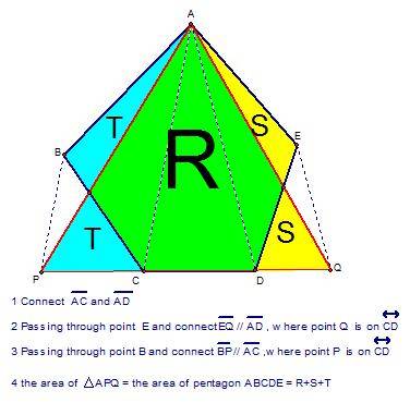

ABCDE is a pentagon,now please construct a triangle APQ
,and both of them must have the same area

Are we assuming this is a regular pentagon?

it may not be a regular pentagon
Well I would be inclined to split the pentagon into three triangles, you should be able to find the area of each triangle using \displaystyle \begin{align*} \frac{1}{2}ab\sin{(C)} \end{align*} or some other method...
Hope you can upload a diagram ,so we can see it clearly
,I will upload mine later
