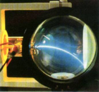

If you have a beam of electrons going through a vacuum without being inside a wire, a magnetic field causes the beam to curve (change direction):
If the electrons are moving along a straight wire, then they can't follow that path, but are instead constrained to a straight path by the electrical attraction of the positive charges in the wire. And of course the electrons pull back on the positive charges (Newton's Third Law!). The net force on the wire (the magnetic force on the electrons) stays in one direction, perpendicular to the wire.

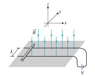

Is it even possible that when a large conducting plate is placed in a magnetic field, and current flow where the plate starts to accelerate due to the Lorentz force... will the charges within the plate change direction and alter the Lorentz force path in any way?

Can you clarify which setup you have in mind here and where you expect a deceleration?
Like a rail gun concept:
Or any other similar idea, where a conductor passes such a magnetic field.
I don't think its true that the Lorentz force direction will change as the conductor starts to accelerate?
The force does not change its direction. The motion of the bar does not do anything: electrons and protons move with the same velocity. The only force you get is from the current flow, and that acts along the rails.

When the conductor changes velocity, the current density vector in the wire changes direction too and this makes the force
\int \mathbf j \times\mathbf B dV
change too. Besides the x component of that force which translates into accelerating force on the rod, there will be also y component of this force that counteracts the flow of current in the circuit.

When the rod on the picture above stands still, the electrons move along the axis y. When the rod moves in the direction of axis x. The electrons move diagonally, in between the direction of y and x.

It is just vector addition of velocities. Wire moves along x. In the frame of the wire, the electrons move along y. Hence, in the lab frame the electrons move diagonally, partially along x, partially along y.
