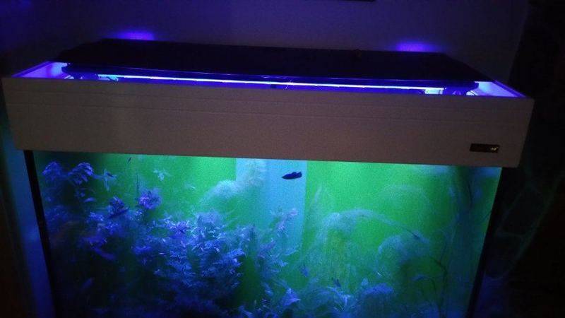

Okay, best to provide some background here. I am trying to understand the light coming from the LED's over my aquarium. I have blue moon lights I think at about 540nm and 450nm. Oddly enough, when they are on, there is a green tinge to the light. I had assumed that this was because the light lost energy as it hit the water, therefore lengthening the wavelength. However, as I tried to further prove to myself that this was what was happening I learned that the wavelength of the light decreases as it hits the water.
Up until now, I was of the understanding that the UV light was higher energy, but there is a contradiction in the above. Is it that the UV light is a more 'concentrated' energy, and that the colour change is due to refraction and / or 'wave-spreading' of the more angular incidences of light (they are only 60 degree lights)? Or is it that the light loses colour temperature?
I am guessing that it is a combination:
- the green tinge is from wavelength being spread as it hits at an angle, combined with some prismatic effect bending green light, present in the imperfect light beam, further than it bends the blue.
- The light also loses energy at the surface and as it dissipates through the water.
Please confirm / correct / elaborate

Light comes in quanta called photons. Each photon has an energy equal to ##h\nu## that is Planck's constant times frequency. The total light intensity is number of photons times energy of each. As light enters the water, its frequency does not change, it still has the same energy. A certain portion of photons will be reflected at the surface, and as they travel through water, they get absorbed. Neither of this processed changes the energy of individual photons, just their number.
There is also light scattering, that changes of direction of light. (This is what makes the sky blue and sunset red).
540 nm is actually green light. Your LED produces both, blue and green.
The greenish tinge could come as a results of one or more of the following:
Stronger absorption of blue light
Stronger scattering of blue light
Fluorescence
Fluorescence occurs when something absorbes a photon of one energy and re-emits a photon of a lower energy.
Fluorescens is quite common when incident light has short wavelength.
And yes, green light will refract at a slightly different angle then the blue light when entering water.

The colour we see is due to the frequency of the light, which does not change. It is the wavelength that changes through different media because the speed of the light is less than c, the speed in empty space. We can safely say that, in these circumstances, there can be no change in the frequency of the light. The wavelength changes as light goes through different media revert to the 'in air' wavelength when it emerges again and when you see it.
If you are getting an apparent change in colour it can either be due to filtering of some of the wavelengths in your lights or fluorescence due to some UV component of your lights and something in your water or the tank walls.
Thick cheap glass has a greenish tinge when you look through the edge of a sheet but your aquarium glass will be nicer quality than that, I would think.

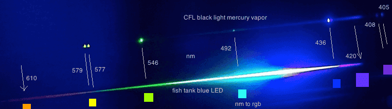

I have a Marineland model 01G33 fish tank light fixture, with a blue LED moonlight setting.
Visually, and photographed against the white lights, my blue LEDs, run though a 1000 lines/mm diffraction grating, show that they are very, very dirty little lights.
By that, I mean that they emit all the colors of the rainbow, from violet to red.
Of course, they are brightest in the blue region.
Upper spectrum is from a blue bulb.
Lower spectrum is from a white bulb.​

Sorry, its 450nm and 465nm on the moon channel.
Photo below (strong algae is a sign of good health, although poor nutrient balance which is what I am supposed to be working on :)
Yes, I think the front glass is low iron (mass production ik).
Looks like it must be fluorescing ... amazing ... the organics and ionics in the aquarium.
I put it down to fluorescence as it is cloudy (rather than rayish, for want of a better word), the blue light nearer the bottom (blue light is known to penetrate deeper due to the higher energy) might eliminate 'scattering' as the major factor. Absorption, and fluorescing ... amazing.
I think I recall that the light does include some UV in its spectrum.

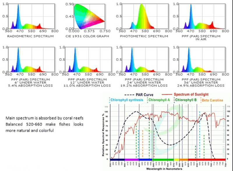

Actually great image to see. I am not sure if you are aware, but there is a reason the aquarium lights have intensity spots like that, and its called Photosynthetically Active Radiation (PAR), It is the bands of the spectrum that plants use to photosynthesise. Never seen it like that. Brings new fuzzier to memory of my first year physics prac. I have attached the curves from my manufacturer.
As you mention green water, please let me clarify that yes, I am in the process of changing from those dirty 'lignosulfonate' chelates to the purer DTPA / EDTA forms for my aquarium, and cancelling the use of that precipitous MNSO4. I am getting there, give me a break!,

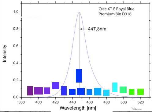

Actually, according to everything I've read over the last 4 hours, the LEDs are very monochromatic.
Cree apparently makes only one model of blue LED: Royal Blue.
My spectral analysis may be boogered by the deficiencies of optical Bayer filtering in dollar store digital cameras.

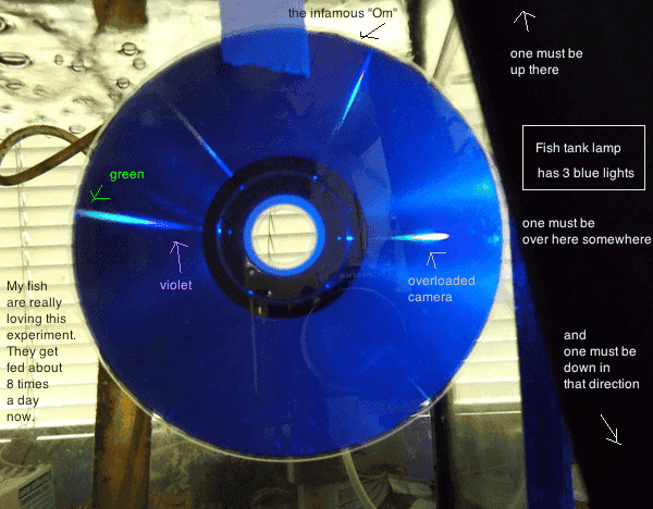

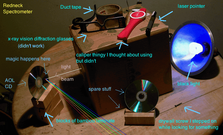

One moment, please...
[an hour later]
Oh. My. God.
Bathroom science...

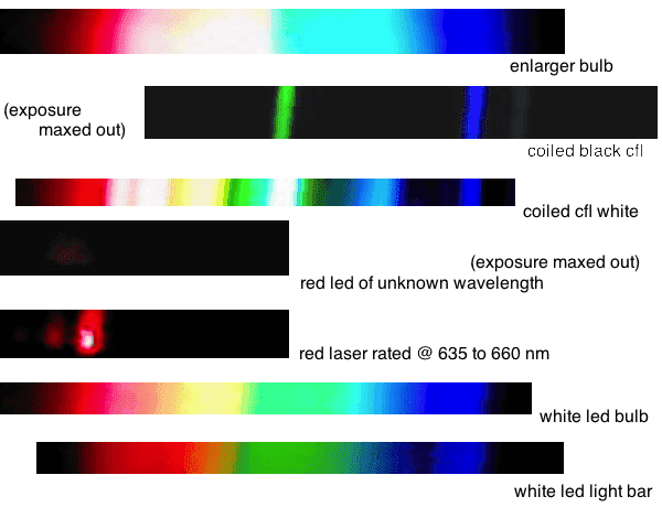

The analysis in a camera is very similar to the analysis by the eye (hardly surprising). It uses just three wide band analysis curves which cannot tell the difference (and nor can your eye) between a monochromatic source and a wideband source with the same colour (metemeric match - see link). If you actually know that the source is monochromatic then three RGV values can identify the wavelength but you need to know it's monochromatic before you can do that.
But I could accept the results of Andy [EDIT with apologies: damned autocorrect!] Resnick's suggested spectroscope as evidence one way or the other.
Not long ago I bought a cheapo spectroscope (sold mainly for lapidary identification). It is great fun to examine (qualitatively) the spectra of many light sources. It could be good for some optical filters too.

I've decided there's no way for me to inexpensively focus the light from the bulb. ie, less than a whole roll of duct tape.
I've also decided I'm chasing a ghost. I have no idea who made my blue LEDs, nor what their spectrum should be.

OmCheeto, My Aquarium Light is a DSunY, with Bridgelux LED's. Sorry for the confusion. Did you check the spectrum without the filtering? Did it change?
I have just done a 50% water change, including makeup salts, and there is a significant change in fluorescence. This is an awesome learning. Not only does it show the amount of organic buildup, but with a bit more research I might be able to pinpoint the organic by the colour of the light. Thank you so much!
Before photo:
[NOPARSE][PLAIN]http://www.gentlespring.com.au/20160728_095436.jpg[/NOPARSE]
After photo:
[NOPARSE][PLAIN]http://www.gentlespring.com.au/20160729_164242.jpg[/NOPARSE]
Example Luminescence: Absorption/Emmitance Spectra (mine is not this one, being green)
[NOPARSE]http://www.gentlespring.com.au/Screen Shot 2016-07-29 at 5.20.45 PM.png[/PLAIN] [/NOPARSE]
Source:
http://www.biotek.com/resources/articles/monitoring-of-algal-growth-using-intrinsic-properties.html
Interesting. A picture is worth a thousands words. Yes, it is possible for fluorescence to create photons of lower energy. Maybe that's happening here.

To my logical brain, since energy is equivalent to mass, it seems that some photons "pass" through the interface at a decreased wavelength (a net decrease in energy), and then some of what that gets through "excites" the algae, which absorbs it and "emits it at an increased wavelength (further decrease in energy).
I now have a UV light on the supply pipe. There for a multitude of reasons, perhaps water clarity and light efficiency will prove to be one of them.
I would like to know more about the experiment you have in mind ... (to see for yourself?) at your leisure!
Bear in mind that I have a reasonable amount of plants, and I fertilise the aquarium, so it may take effort to get the fluorescence. Unless, of course, you are checking the water quality of the river?
Light does not lose energy upon passing through an interface just because the wavelength changes.
Didn't say that it does! In fact, my understanding is that the decreased wavelength = increase in energy, The net decrease (referred) therefore being due to energy donated by those 'photons' rejected at the interface. If you know better I would love to hear a better explanation!
The correct explanation is that the energy doesn't change as the light passes through the interface. The dependence of energy on wavelength only applies if the light stays in the same medium, not when it enters a different medium. If you are looking at light passing through various interfaces between mediums you are better off using the frequency vs energy relationship, since the frequency of the light doesn't change.
