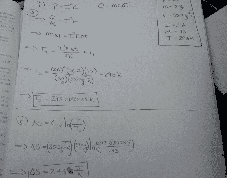

Consider a thermally insulated resistor with resistance R=20 Ω and mass m=5.0 g. The resistor is made of a material with specific heat capacity c=850 J/(g-K) and carries a current of 2.0 A for a time period of 1.0 s.
a) Calculate the increase in the temperature of the resistor if it has initial temperature Tin=20oC. Recall that the power dissipated by a resistor is given by P=I²R.
b) Determine the increase in the resistor's entropy over the period that the current passes through it.
My solution is in the attachment. I just wanted somebody to have a look at it and let me know if it looks okay since I don't feel too sure about it.

I note that you used 50g for your mass in the final calculation rather than 5g...
oh woops, the answer should have been ΔS = 0.273 J/K
I think part (b) is a trick question but I'm going to wait for other responses if any.
As a hint I don't agree with the computed answer in post 3.
Your specific heat capacity is unrealistic. It should be per kilo not gram.
Yes, the approach is correct, but the heat capacity is off by a factor of 1000.
