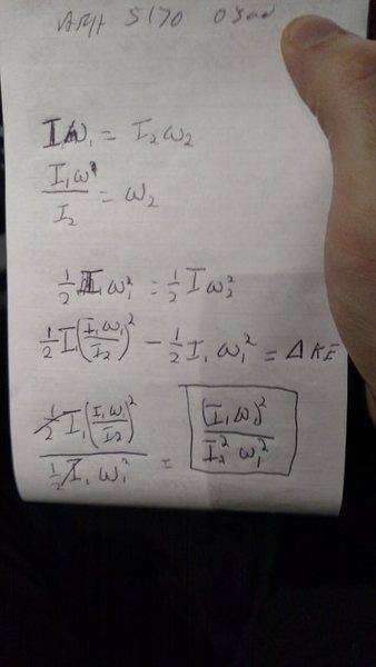

So I think I solved the problem do you mind looking over my work?
Posting algebra as images, even if readable, makes it hard to make comments referencing specific lines. At the least, please number the equations, but better still, please take the trouble to type the algebra into the post.
Your third equation looks like conservation of energy, which is clearly not valid.
There are two errors in the next equation.
You should express ##I_1## and ##I_2## in terms of m and r. The r's are the same for both disks so you can be pretty sure that the r's will disappear somewhere along the way. But the important thing is to incorporate the given information that the disks differ in their mass.
Sorry for the photo reply I'm on my moble. I'll do my best to type it out once I'm back on my desktop.
If I rework using I = mr2 and ω = v/r, would the rest of my thought process be correct in using the angular velocity at moment two, to find a new kinetic energy, which could then be subtracted from the original to determine its change?
Minestra said:
I = mr2
Not the right formula for a disk.
As I mentioned, there are errors in some of your previous equations.
Leave the ω's alone. There's no need to introduce linear velocity. The idea is to incorporate the different masses, hence the differing moments of inertia for the disks. Just use the (correct) form for the MOI of a disk and analyze the collision.

Which of course results in an incorrect answer from web-assign. I understand I made some errors somewhere, I would greatly appreciate being told exactly what I did wrong. I know it's not the best for my education but I need to submit the assignment by tomorrow night and my professor is grossly unavailable when it comes to help (numerous emails throughout the semester with not a single response, I have confirmed with other students that he does this) and I fear I will not be able to solve it.
Minestra said:
Next we take this new ω which should be our speed after collision and substitute it into the kinetic energy equation:
$$\frac{1}{4}m_{1}r^{2}\omega _{1}^{2} = \frac{1}{4}(m_{1}+m_{2})r^{2}\frac{m_{1}}{m_{1}+m_{2}}$$
Not sure what you are doing there. I think what you mean is that the expression on the left is initial KE and the expression on the right is the final KE. They are clearly not equal.
If so, you have made a mistake or two in substituting for ω2 on the right. Try that step again.
