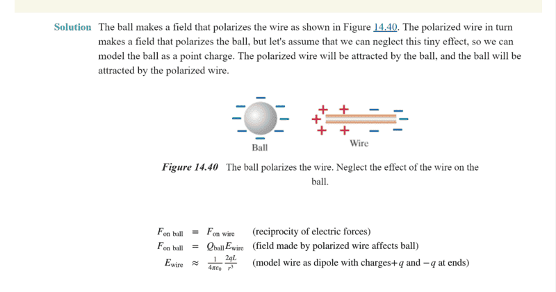

I found it in my textbook "Matters and Interactions" 4th edition. I'll upload the section of the textbook:
Ok.
First, the equation is specifically for the case where r is the displacement from the centre of the wire along the line of the wire. This is not as general as you implied in post #3, but does apply here.
Secondly, q in this equation is the dipole charge, not the point charge. They will be different. So you need to find the dipole charge. You can use the method I outlined at the end of post #4.

Sorry, I said yes too quickly.
The expression you used for Ewire in post #7 is for the field the wire of length L creates at a point r2>>L away in the line of the wire. For the purposes of the equation there you want the field it produces at its own centre. The expression does not apply because r2 wouid be zero!
There is a very simple way to get the field at the middle of a dipole.
