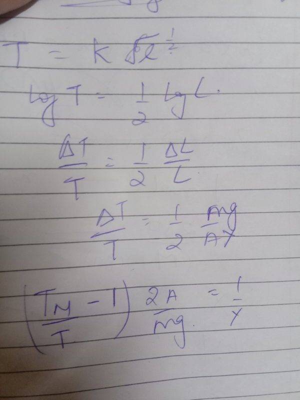

I tried taking log and then diffrentiate the standard equation for time period of a pendulum but i am not getting the correct answer

The period of a pendulum depends on its length. I don't understand your method at all.
Can you relate the new length of the pendulum (with mass ##M##) to the old length (without mass ##M##)?
