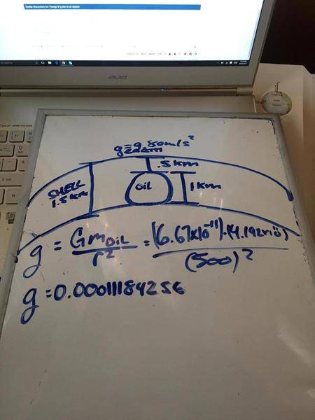

The first thing I attempted for this problem was to visualize the given scenario, we happen to have a sphere of oil that is 1.00 km in diameter, the center of this oil deposit is directly 1.00 km beneath the surface of the earth. Which implies that the top of the sphere is only 0.5 km or 500m beneath the surface of the earth.
The next step I took was to find all the values of each sphere (earth, oil).
Sphere of Oi:
Radius: 500m
Volume: 5.24×10^8m^3
Density: 800 kg/m^3
Mass: 4.192*10^11kg
Earth:
Radius: 6.380*10^6m
Volume: 1.087*10^21m^3
Density: 5540 kg/m^3
Mass: 5.97*10^24kg
Having all this information, I do not know what to do next to figure out the g within the top of the sphere and how I find the percentage it would differ. I know that if I calculate the gravitational field for Earth i'll get 9.80 m/s^2. If I do the same for the sphere of oil ill get 0.00011184256m/s^2 which is a reasonably small number for a gravitational field. I do not know if I should subtract both gravitational fields and then do a ratio with my result and 9.80m/s^2 to get a percentage. Any help will be appreciated!

https://ton.twitter.com/1.1/ton/data/dm/658364940089032707/658364940126846976/-y9GZJfc.jpg
I don't know if I am visualizing this correctly, also how do I find the mass of a spherical shell? Is that what I even have to find for?
You say you calculated the field from the sphere of oil, but is that at the edge of that sphere or at the surface of tne Earth?
If you were to take away the oil and replace it with the rocks that would otherwise have been there, how much would that increase the field by?
You do not need to worry about spherical shells.
Likes Geoesque
I don't know why the image link was broken, but I got it here to work. This is what I am visualizing.

In your calculation of the field due to the oil sphere, you used r=500m. I ask again, is this supposed to be the field at the edge of the oil sphere or the field at the Earth's surface?
The field is suppose to be of the edge of the oil sphere, cause I assumed that the distance from the sphere to Earth is 500m from the Earth's surface.
Or should I subtract the 500m from the radius of the Earth since the sphere is beneath the surface?
But you want to know how the oil sphere affects the total field at the Earth's surface, no? The field at the edge of the sphere is not interesting.
I thought that when the question asked "Estimate by what percentage g directly above the pocket of oil would differ from the expected value of g for a uniform Earth?" It was asking to find the field directly above the pocket of oil, which is equivalent to 500m below the surface of the Earth due to the it's stated fact that the center of the pocket of oil is 1km directly under the surface of the earth.
No, I don't think that's the right interpretation. g is the Earth's field at its surface, so the question is asking for how the field at the surface changes. "Directly above" just means it is in a vertical line above the centre of the sphere. To imply touching the oil sphere, it should say something like "immediately above".
If that is the case then how do I calculate for that?
Same formula, different r.
