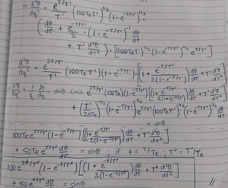

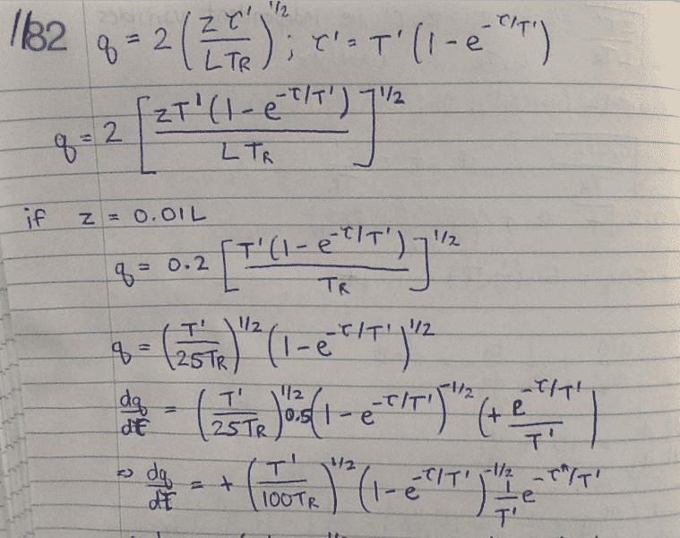

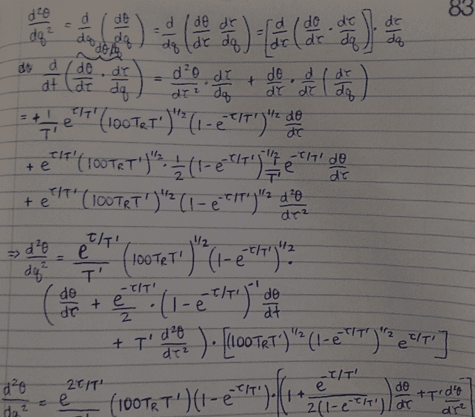

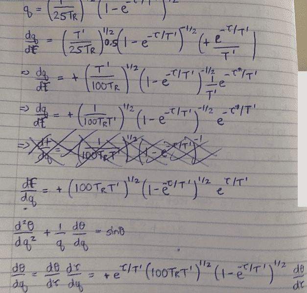

Hi there, I was just trying to perform a change of variable on a differential equation as shown below. The original second order ODE is written in terms of a dependent variable ## \theta ## and independent variable ##q##. I have used the expression ## q = \sqrt{\frac{z\tau'}{LT_R}} ## and ##\tau' = T'(1-e^{\frac{-\tau}{T'}}) ## (where ##z## and ##\tau## are also independent variables, while ##L, T',## and ##T_R## are known constants). I am only considering the case of ##z = 0.01L## and am thus only solving this equation for a varying ##\tau##. (In this case, ##\tau## is a purely real and positive number.) I have posted my work below to transform the second order ODE into a function of ##t## instead of ##q##. (I may have used ##t## and ##\tau## interchangeably out of bad habit--my apologies if this causes confusion.) If you could possibly check it to see if there are any errors, that would be greatly appreciated as I'm still a little uncertain if I've applied the chain rule correctly in certain parts.

The final solution I get (it is partially cut in the last image) is:
$$ 100e^{\frac{2t}{T''}}(1-e^{\frac{-t}{T''}})[(1 + \frac {e^{\frac{-t}{T''}}}{2(1-e^{\frac{-t}{T''}})}) \frac {d\theta}{dt} + T'' \frac {d^2\theta}{dt^2} ] + 50e^{\frac{t}{T''}}\frac {d\theta}{dt} = sin(\theta) $$
which can also be expressed as:
$$ 100T''(e^{\frac{2t}{T''}}-e^{\frac{t}{T''}}) \frac {d^2\theta}{dt^2} + 50e^{\frac{t}{T''}}[(e^{\frac{t}{T''}}-1)(2+ \frac {1}{e^{\frac{t}{T''}}-1}) + 1]\frac {d\theta}{dt} = sin(\theta) $$
which is equivalent to:
$$ 100T''(e^{\frac{2t}{T''}}-e^{\frac{t}{T''}}) \frac {d^2\theta}{dt^2} + 100e^{\frac{2t}{T''}}\frac {d\theta}{dt} = sin(\theta) $$

I am trying to solve the ODE:
$$ \frac {d^2 \theta}{dq^2} + \frac {1}{q} \frac {d \theta}{dq} = sin(\theta) $$
at ## z = 0.01L ## for all ##\tau##. I know ## q = \sqrt{\frac{z\tau'}{LT_R}} ## and ##\tau' = T'(1-e^{\frac{-\tau}{T'}}) ## and so have applied the above change of variables to the initial ODE. This is all being done to find ##\theta## at ## z = 0.01L ## for all ##\tau## so that I can use this as a boundary condition for another problem I am working on that involves modelling an electric field propagating in a homogenous medium. For more context, page 32 from "Super-radiance multi atomic coherent emission" by Benedict et al. may help. But it is all once again being done essentially to find ##\theta## at an early ##z## for the entire ##\tau## domain to use as a boundary condition for further equations which are found in the aforementioned textbook. I couldn't use ## z = 0## since this makes ##q = 0## for all time. I am just skeptical if my solution is exactly correct since if I rearrange the above equation with just ##\frac {d^2 \theta}{d\tau^2}## isolated, then I have to divide by 0 in the case ##\tau = 0##, but this is a physical situation and I wouldn't expect this to happen.

Ahh sorry for the confusion. I was following the same notation from where I got the equations; ##T'## is constant and ##\tau'## is not the derivative but rather just another symbol used to denote it is different from ##\tau##

Then, it is not necessary to change the variables. Your can try RK4 right on these data.
Fair enough, I will certainly implement that. Although I am still interested in obtaining the expression for the second order DE in terms of ##\tau##.
