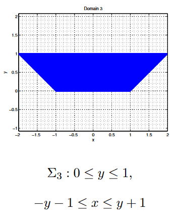

Choose the correct change of variables among the three possible choices to map ##\Sigma## to a rectangular region.
None for now
Hello,
This problem comes just prior to introducing change of variables with Jacobian.
Given the following region in the x-y plane, I have to choose (with justification) the correct change of variables associated, for ##u\in [0,2]## and ##v \in [0,1]##.
The correct choice here is a), but I do not understand why...Solution only mentions that a possible change of variable for x would be ##x = -(y+1) + u(y+1)##, so we get to solution a).
Here is my question: is there a systematic way of finding the appropriate change of variables? How did the instructor suddenly decide that choosing the previous substition would be a good idea to solve the problem? I have no idea where to begin.

You can at least verify that ##u=0## and ##u=2## correspond to the left-hand boundary and the right-hand boundary, respectively, for the region in the x-y plane.
Also, ##u=1## corresponds to the vertical line, ##x=0## which passed through the middle of the region.
Here is my question: is there a systematic way of finding the appropriate change of variables? How did the instructor suddenly decide that choosing the previous substitution would be a good idea to solve the problem? I have no idea where to begin.
Thank you very much for your help.
It's hard to guess how the instructor decided on that substitution (whether it was sudden or not). It's also difficult to guess the reason for choosing that particular region for the new variables, except to observe that the new region is in the 1st Quadrant.
Let's examine choice a), with emphasis on the defined mapping for new variable, ##u##. - The mapping for variable ##v## is trivial.
Rewrite
##\displaystyle u=\frac{ x+y+1 }{ y+1 } ##
##\quad \displaystyle=\frac{ x }{ y+1 } + \frac{ 1 }{ y+1 } ##
##\quad \displaystyle=\frac{ x }{ y+1 } +1 ##
The effect of that final term of 1 is to shift the rectangle 1 unit in the positive ##u## direction.
Let's drop that final ## + 1 ## and change the variable name from ##u## to ##n## so as to avoid confusion. We now have:
## \displaystyle n=\frac{ x }{ y+1 } ##.
Solving for ##x## gives : ## \displaystyle x=n\left(y+1 \right) ##.
If you think of the rather unusual practice of graphing ##x## as a function of ##y##, we have that this gives a line with slope ##n## and ##y## intercept of ##-1## .
Any such line with slope ## n \in [ -1,~1]## will intersect the trapezoid at all values of ##y \in [0,~1]## and nowhere else.
