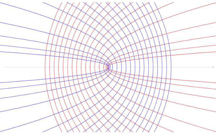

The family of curve for ##y^2=4u(u-x)## is given by the blue curves, and that for ##y^2=4v(v+x)## is given by the red curves.

Evaluate the integral ##I## in the uv-plane. (The blue curves are ##u=1##, ##u=2##, etc. The red curves are ##v=1##, ##v=2##, etc.)

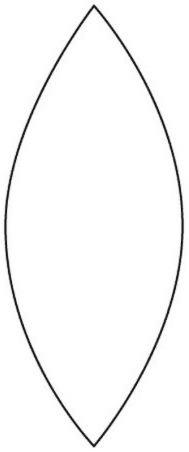

Pointed ellipse (Its left side is the red curve ##v=a## and its right side is the blue curve ##u=a##):
The pointed ellipse is symmetrical about the x and y axes. Thus the area of the pointed ellipse in each quadrant is the same.

As ##u\to0##, the blue parabola gets narrower and sharper until it becomes a half line that is the negative x axis. Similarly, as ##v\to0##, the red parabola gets narrower and sharper until it becomes a half line that is the positive x axis. The takeaway is both ##u=0## and ##v=0## don't give the whole x-axis but only half of it.
Then the overlap of the region ##0\leq u\leq a## and the region ##0\leq v\leq a## is the pointed ellipse. But somehow it should be half of it.
