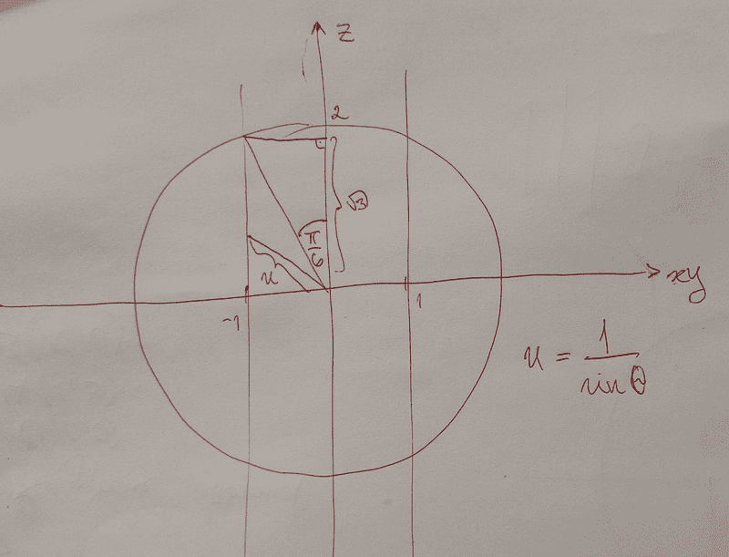

Summary: Find the volume V of the solid inside both ## x^2 + y^2 + z^2 =4## and ## x^2 +y^2 =1##
My attempt to answer this question: given ## x^2 + y^2 +z^2 =4; x^2 + y^2 =1 \therefore z^2 =3 \Rightarrow z=\sqrt{3}##
## \displaystyle\iiint\limits_R 1dV = \displaystyle\int_0^{2\pi}\displaystyle\int_0^{\pi}\displaystyle\int_0^2 1 \rho^2 \sin{(\phi)} d\rho d\phi d\theta =\frac{32\pi}{3}##
Now using ##z=\sqrt{3}## we get ## \displaystyle\int_0^{2\pi}\displaystyle\int_0^\pi \displaystyle\int_0^{\sqrt{3}} 1 \rho^2\sin{\phi}d\rho d\phi d\theta = 4\sqrt{3}\pi##
Hence the area of the solid is ##\frac{32\pi}{3} -4\sqrt{3}\pi =\frac{4\pi}{3}*(8-3^{3/2})##

I think you didn't understand correctly the statement of the problem. The key word for understanding (at least for my brain) is the word "inside". This means we have to convert equalities to inequalities and look for the region V where both inequalities hold, $$V={(x,y,z):x^2+y^2+z^2\leq 4, x^2+y^2\leq 1}$$.
But there is more, what region/shape do you think the inequality $$x^2+y^2\leq1$$ is? (hint: think in 3D)

I am afraid you are wrong here, because all you do is to calculate the volume of a sphere with radius 2 and another with radius ##\sqrt{3}##. And then calculate the volume of the spherical shell with ##\sqrt{3}\leq r\leq 2## This is not what the problem asks for.

Why not? The first equation represents a sphere of radius 2, centered at the origin. The second equation represents a circular cylinder of radius 1, whose central axis lies along the z-axis.
Being able to draw a sketch of the region of integration makes it less likely that you will set up the limits of integration incorrectly, as you did in your recent thread.

The body lives in a sphere, so converting to spherical coordinates might be fruitful. So put
[tex]
x = r\cos\phi \sin\theta,\quad y = r\sin\phi\sin\theta, \quad z = r\cos\theta
[/tex]
where ##\phi \in [0,2\pi]## and ##\theta \in [0,\pi]##. Due to symmetry it suffices to let ##\theta \in [0,\pi /2]##. For ## \theta \in [0, \pi /6]## we have a piece of the volume given by
[tex]
\int _0^{2\pi} \int _0^{\pi/6} \int _0^2 J \mathrm{d}r\mathrm{d}\theta \mathrm{d}\phi \overset{?}= \frac{8\pi}{3}\left (2-\sqrt{3}\right ),
[/tex]
where ##J## is the Jacobian. Now, for ##\theta \in [\pi/6,\pi /2]##, the maximum radius depends on ##\theta##. More precisely ##r(\theta) = \frac{1}{\sin\theta}##. Thus, the remaining volume is
[tex]
\int _0^{2\pi} \int _{\pi /6} ^{\pi /2} \int_0^{\frac{1}{\sin \theta}} J \mathrm{d}r\mathrm{d}\theta \mathrm{d}\phi \overset{?}= \frac{2\sqrt{3}\pi}{3}.
[/tex]
The two sum up to the upper half of the body's volume, so multiply by ##2## to get the entire volume.
That's how I usually sketch these things. Finding the necessary limits is then straightforward.

We need the volume of the solid. You have computed the volume that is left over after the smaller ball (with radius ##\sqrt{3}##) is erased inside the bigger ball. That is definitely not what you are tasked to find.
My solution's strategy is that I break the triple volume integral into the volume of the cylinder from ##z=-\sqrt{3}## to ##z=\sqrt{3}## and the volume of two spherical caps from ##z=\pm\sqrt 3 ## to ##z=\pm 2##. So the integrals are $$\int_{-\sqrt{3}}^{\sqrt{3}}\int\int_{x^2+y^2\leq 1}1dxdydz+\int_{-2}^{-\sqrt{3}}\int\int_{x^2+y^2\leq 4-z^2}1dxdydz+\int_{\sqrt{3}}^{2}\int\int_{x^2+y^2\leq 4-z^2}1dxdydz$$
The integration with respect to x and y is done in polar coordinates and then follows the integration with respect to z. For the first term after we integrate in polar coordinates we get a function which is constant w.r.t z, but for the 2nd and 3rd term we get a function that depends on z.

Method 1
## V= \frac{32\pi}{3} - \displaystyle\int_0^{2\pi} \displaystyle\int_{\frac{\pi}{6}}^{\frac{5\pi}{6}} \displaystyle\int_{\csc{\phi}}^2 \rho^2 \sin{\phi} d\rho d\phi d\theta = \frac{4\pi}{3} (8 -3\sqrt{3})##
The integral is correct. I haven't checked if the evaluation is correct.
edit:
[tex]
\begin{align*}
\int_0^{2\pi} \displaystyle\int_{\frac{\pi}{6}}^{\frac{5\pi}{6}} \displaystyle\int_{\csc{\phi}}^2 \rho^2 \sin{\phi} d\rho d\phi d\theta &= 2 \int_0^{2\pi} \displaystyle\int_{\frac{\pi}{6}}^{\frac{\pi}{2}} \displaystyle\int_{\csc{\phi}}^2 \rho^2 \sin{\phi} d\rho d\phi d\theta \\
&=\frac{2}{3} \int _0^{2\pi} \int _{\pi/6} ^{\pi /2} \left (8\sin\phi - \frac{1}{\sin ^2\phi}\right ) d\phi d\theta \\
&= \frac{4\pi}{3} \int _{\pi /6} ^{\pi /2} \left (8\sin\phi - \frac{1}{\sin ^2\phi}\right ) d\phi \\
&= \frac{4\pi}{3} \left (-8\cos\phi + \frac{1}{\tan\phi}\right )\Bigg\vert _{\pi /6}^{\pi /2} \\
&= \frac{12\sqrt{3}\pi}{3}
\end{align*}
[/tex]
so
[tex]
V = \frac{32\pi}{3} - \frac{12\sqrt{3}\pi}{3} = \frac{4\pi}{3} \left (8-3\sqrt{3} \right ).
[/tex]
