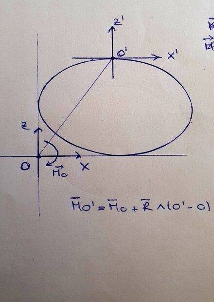

I am an aerospace engineering working on my thesis and i am trying to solve a little problem.
In the picture you can see an "aeordynamic" body. The CFD analysis gives me the forces and the moments acting on this body. How can i calculate the momentum acting on the body with respect to O'? In particular, how do i find "R"? I want to point out that the moments that the CFD gives me are just values!
Thank you very much to everyone!

If I understand the diagram correctly, there are no forces acting on the body, only moment Mc about point O.
I did not draw forces but only because i wanted to focus on the moments.
What i have is basically a chart that says for, every angle of attack, the value of the forces and the moments acting on the 3 axis, in the Oxyz frame of reference.

It is the law used to change the pole of the moment. The problem i think is just R which is defined as the summation for "i" that goes from 0 to N of F(i). But i am not very sure if i can use the forces coming from the CFD.

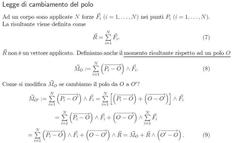

Here is the theory. It is in italian but math is still valid..

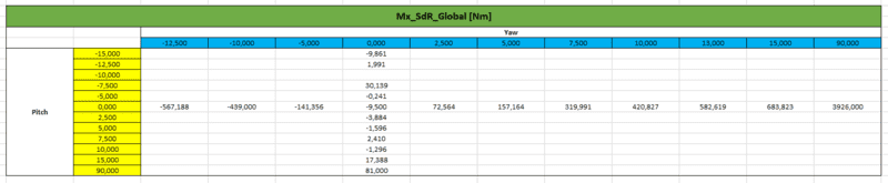

I am confused. What explicitly is the output you get from CFD ?
Unfortunately i cannot give informations but this is what it looks like. I have one of these charts for Fx,Fy,Fz,Mx,My,Mz

Is F the same as R? Is M the same as ##M_O## ? Then can't you use the cross product equation in #14 ?
That was my idea. The problem now is this. I need to move from the nose (0 0 0) to the mast of the helo, which is located at (2 0 2.4) meters. Assumig i want to keep my problem 2 dimensional so i can use just the charts of Fx and Mx. What distance do i calculate as O' - O? 2 meters (the projection of the mast on the x axis) or 3.2 meters (the real distance)?
Thank anyway for the help!
The 2D problem (on a flat plate in x-z plane) is still embedded in 3D. The moments are axial vectors which point along the y-axis (out of page) as you draw them. Use the cartesian components to do the vector math in the vector equations you showed in #14. You never need to calculate the length OO' explicitly
