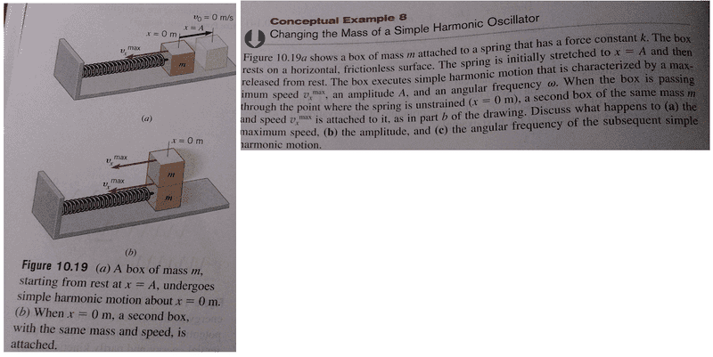

I find this task very hard to understand. First of all, when adding more mass, wouldn't that change the acceleration, according to F=ma? And in that case the velocity should also change when adding more mass, shouldn't it? That would then also change the amplitude and angular frequency. When I think of it intuitively, I think that adding more mass will increase the inertia, and hence make the amplitude less and also the frequency. Why is this wrong?
I don't understand how to think about the physical concepts in this example. If you understand it, please explain how you reason about it!
When the second box is "attached to" the first box, you can think of it as a "collision" between the masses. Can you think of a physical quantity that is conserved during the "collision"?
Hm first of all I don't see what makes the second box stick together with the first box, but maybe that doesn't matter. So let's think of it as a collision. Is it then correct to see this situation as equivalent to the second box was put in front of the first box, and then the first box collides with the second box and "drags with" the second box? In that case we have a completely inelastic collision, and kinetic energy is preserved.
KEf = KE0, that is
m1*vf1^2 + m2*vf2^2 = m1*v01^2 + m2*v02^2

That all looks right to me. The wording of part (a) is a little vague. They ask "what happens" to vmax. I think you are right that it is reduced by a factor of 1/2. How do you know it's not the right answer?
I also still don't know what makes the second box stick to the first one? Maybe that doesn't matter, but why not?
Unfortunately, the problem statement is not very clear on the meaning of "attached to". But I don't see any other way to interpret the problem except to assume that it's equivalent to a totally inelastic collision.
I also wonder, if we see this as an inelastic collision, is it then correct to see this situation as equivalent to a situation where the second box was put in front of the first box, and then the first box collides with the second box and "drags with" the second box? Please help to clarify so I can understand this.
Yes, that's right.
In my book the answer is given as that the speed remains the same. It seems they assume that the second box attached will already have an initial speed equal to the first box. But it's not said clear in the task. I'm glad I'm not the only one who interpreted it this way anyway. :)

What about the other questions, b) and c)? In b) they ask if the amplitude changes. I find this quite hard to solve also. I know the force of the spring relates to the amplitude like F=-k*A. Does this help finding out how the amplitude will change? How can we find that out?
You might want to consider energy here. Can you describe what type of energy the system has at x = 0? At x = Anew? Are these two energies related? Can you use this to relate Anew to vmax? How is Aold related to vmax?
At x=0 the system has kinetic energy only. At Anew it is potential elastic energy. Yes they are related somehow. I know they can't both be max at the same time. So when PE=max KE=0 and vice versa. I also know that if there is no non conservative forces doing work, then KEf+PEf = KE0 + PE0. Here PE0=0 and KEf=0, so we get PEf = KE0 or
1/2*k*A^2 = 1/2*m*vmax^2
Am I on the right track? How can we continue from here?

Yes, you're on the right track!
But, be careful with the interpretation of the mass m. Apply this equation to two cases: (i) before the second mass is added (ii) after the second mass is added.
Ah, I see now. Anew = √2*Aold. Great.
