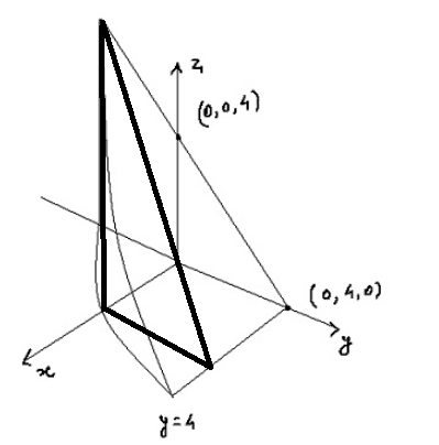

The sketch is something like this (slice perpendicular to x axis, as asked). This is what I visualise now
x axis extremes: From ##x=0## to ##x=\sqrt{23}##
z axis extremes: From ##z=0## to ##z=4-y##
y axis extremes: From ##y=\frac{x^2-23}{4}## to ##z=4-z##
But there is obviously something wrong with either the y or z extremes...

The new order of integration is y, z, and finally, x, so it's best to list the limits on those three variables in that order. I have quoted what you wrote, but have rearranged the order in what I've quoted.
Nice drawing!
No. Look at your drawing. The y values at the ends of the triangle base run from a point on the parabola to the line y = 4 in the x-y plane. The volume element is a cube of size dy*dz*dx. If you visualize a stack of these cubes, the stack will taper down to 0 as the y values increase to 4.
Yes.
No, the x values run from 0 to the value at the point ##(\sqrt{39}, 4)##. Do you see why?

Oh yeah so y-axis would be:
From ##y=\frac{x^2-23}{4}## to ##y=4##
I do not see why you state those extremes for the x axis. I see how it goes from 0 to the parabola. Besides, you stated 3 values. Please explain your reasoning

Yes.
Look at the triangle you drew in your sketch. As the triangle sweeps across from the y-axis, the y values range as you said above, and the x values go from 0 to the point on the parabola at which y = 4. IOW. to the point ##(\sqrt{39}, 4)##.

Your heavy black triangle is not perpendicular to the x-axis; it slants a bit towards the yz-plane.

OK I've checked the answer:
$$\int_0^{\sqrt{39}}\int_0^{\frac{39-x^2}{4}}\int_{\frac{x^2-23}{4}}^{4-z} f(x,y,z) dydzdx$$
I understand the y-axis extremes.
Regarding z axis extremes; I get that its lower bound is ##z=0##. Its upper bound is the plane ##z=4-y## ; why is ##\frac{39-x^2}{4}## the correct upper bound then?
Regarding x-axis extremes. I have the same trouble dealing with the upper bound of x; why is ##\sqrt{39}## ?
The equation of the plane is z = 4 - y. The 3-D surface that the parabolic cylinder represents intersects the plane in a curve. Every point on this curve in the z = 4 - y plane lies above the parabola in the x-y plane, so these points satisfy both z = 4 - y and y = (x2 - 23)/4. For the upper bound for the y integration, they have replaced y in the equation z = 4 - y, getting z = (39 - x2)/4.
Again, look at the triangle you drew. These triangles start on the y-axis (with x = 0), and sweep out on the pos. x-axis to the point where the parabola crosses the line y = 4 in the x-y plane. What is the y-coordinate at that point?
Likes JD_PM
You get ##\sqrt{39}##, indeed. Thank you.
