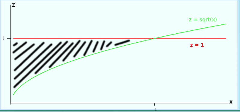

I'm given this definite integral:
[itex]\int_0^{1}\int_{\sqrt{x}}^{1}\int_{0}^{1-y}f(x,y,z)dzdydx[/itex]
I need to change the order to dydxdz, but I'm stuck trying to get the limits of integration wrt y.
[itex]\int_0^{1}\int_{x^2}^{0}\int_{}^{}f(x,y,z)dydzdx[/itex]
How do I find the limits of y?
Just look at the original iterated integral to see the region over integration occurs.
z = 0 to z = 1 - y
y = sqrt(x) to y = 1
x = 0 to x = 1.
Sketch that region and it will help you determine the limits of integration for a different order of integration.
