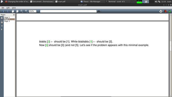

I just tried to compile under a different linux distribution, and the problem remains. The order of the references is exactly the same as in the .bib file.
I could reproduce the problem with a "minimal working example".

Here's introduction.tex:
Code:
blabla \cite{author2} $\leftarrow$ should be [1]. While blablabla \cite{author1} $\leftarrow$ should be [2].
Now \cite{author5} should be [3] (and not [5]. Let's see if the problem appears with this minimal example.

Here's the screenshot of the problem:
Edit: Someone is telling me it's because I use \nocite. Commenting that line indeed get rids of the problem, but now I have less references at the end of the document. In many papers I've seen, they only cite a few references and they have a large list of references at the end of the document. How do they reach this?
The problem is the \nocite{*}. This puts all the entries that are in the bib file in the bibliography, in order of appearance in the file. If you want to still use nocite, you need to move it to the very end of main.tex, just before the bibliography. It will then load all the remaining entries in the bib file after those that have already been cited.
Likes fluidistic
Thank you very much. Problem solved.
