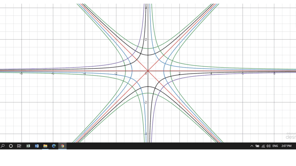

Here is what I got for the U V axes. Ok, I understand the 1st sentence that the region is in the first quadrant (upper right) of XY plane. But, I can't in u v axes what is equal with first quadrant in XY plane.
However, 2nd explanation implies (for me) that in 1st quadrant, there is 2 option: x > y and x< y but x,y are both positive. To satisfy this, so u must be > 0 and u < 0 (which define the limits : ##-\infty<=u<=\infty##. Is that true?
Yes, I think you understand now.
