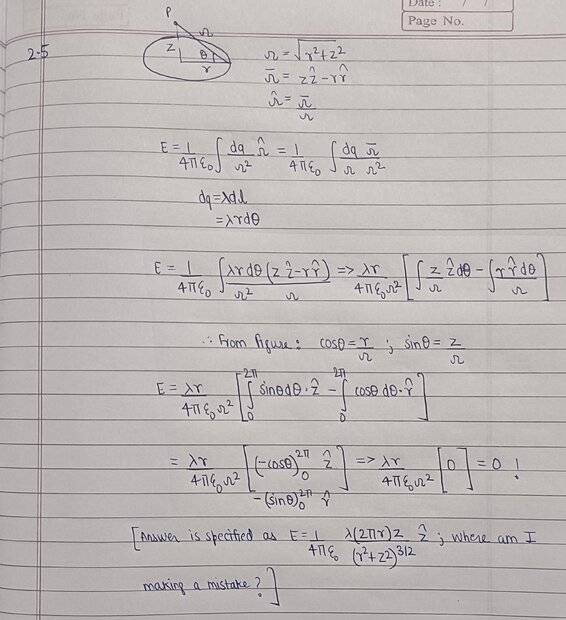

Problem 2.5 from Griffiths EM:
Find Electric Field at a distance z above center of s circular loop of radius r that carries uniform line charge λ
E= ##frac{1/4πϵ} * ( \int {1/r^2} ) \hat r \ dq##
Hi.
I have solved the problem below as shown in the attached image. However I'm at a loss to figure out where I am making a mistake, and I know it is indeed a big goof up. Requesting guidance over identification and rectification of this big goof up.
(Edit- I can solve this problem in the component form by formulating that only vertical components remain while all horizontal ones are canceled by each other. My aim is to solve this problem in the generic ##\vec r## & ##\hat r## style which is used by Griffiths in his Examples for Chapter 2 to achieve the same result wrt vertical components)
Suggest you start over. With what you have, you need to so an integral around the ring with angle ## \phi ##, rather than ## \theta ##. This one is not a difficult one to simply write out the answer, taking advantage of the symmetry, so that the result will point in the z direction.
Likes PhDeezNutz, hutchphd and warhammer
Yes, your mistake was in confusing the angles. Note that angle ##\theta## is constant for any element ##dq## around the ring. You made an early error in writing this charge element. It should be ##dq=\lambda~r~d\phi.##
Likes hutchphd, warhammer and jim mcnamara
Also, it needs to be pointed out that ##\hat r## is not a constant vector. This needs to be kept in mind when doing integrals in cylinder coordinates.
Likes warhammer

@Charles Link & @kuruman Thank you so much for your prompt responses. I have a couple of questions just to ensure I have understood what you both have advised correctly:
i) I should have used Φ instead of θ as the former is a angle on the plane of circle that actually sweeps around from 0--> 2π to give the circle, whereas the latter is a fixed angle. I cannot use θ also because it is not in the circle's plane that is sweeping around. Is this correct?
ii) Using the corrected approach, how will then the second integral comprising of ##\int frac { (r * \hat r )/ cursive r} \ dΦ## turn out to zero mathematically?

Thank you for your response. Based on your thoughts, ## \hat r## is not constant, in the sense that its direction is not fixed and as we go along the circle its direction changes so to speak. So along the length of the circle 2 symmetric elements point in opposite direction (and by symmetry) which cancels them all out.
I hope my interpretation of your response is correct..
Yes. Since the directions of the basis vectors in curvilinear coordinates change, you cannot treat them as constants and bring them out of sn integral as you can do with Cartesian basis vectors. In fact, it is not even clear what ##\hat r## would mean outside the integral as the point where it would be considered would be ambiguous.
Edit: What you can do is to express the curvilinear basis in a Cartesian basis and then take the Cartesian basis vectors out of the integral as they are constant.

I see it now. So for fun sake were I to also prove this symmetric reasoning in terms of mathematics I should drop usage of ##\hat r## and instead use our Cartesian System..
So I think if I do that, my ##\hat r## should be ##= z* \hat z - (x* \hat x + y* \hat y)## as the circle technically lies within the xy plane?
Note: You can still use cylinder coordinates to perform the integral.

It should be ##\mathbf{\hat r}=\cos\phi ~ \mathbf{\hat x}+\sin\phi~\mathbf{\hat y}##, where ##\phi## is measured from the ##x##-axis in the xy-plane.

I disagree. By the OP definition r has a ##\hat z## component and that is the only surviving term, giving the result. Each of you has the Physics correct.

But shouldn't the separation vector ##\mathscr {\hat r}## be what I mentioned in #9.. I'm imagining it as a point moving from source point present on the circle in xy plane to destination point on the z axis. Is this visualisation wrong?
(Edit- I think in the original post and different places I may have muddled up ##\hat r## & ##\mathscr {\hat r}## )

I'm not sure if you meant to have the hat on the (script) r there. Using Griffith's notation, you would have
\begin{align*}
\mathbf r &= z\,\mathbf{\hat z} \\
\mathbf r' &= r \cos\phi \,\mathbf {\hat x} + r \sin\phi\,\mathbf {\hat y} \\
\mathbf d &= \mathbf r - \mathbf r' = z\,\mathbf {\hat z} - (r \cos\phi \,\mathbf {\hat x} + r \sin\phi\,\mathbf{\hat y}) \\
\hat{\mathbf d} &= \mathbf d/\| \mathbf d \| = \frac{z\,\mathbf {\hat z} - (r \cos\phi \,\mathbf {\hat x} + r \sin\phi\,\mathbf{\hat y})}{\sqrt{r^2+z^2}} \\
\end{align*} where I used ##\mathbf d## to represent Griffith's script-r character. It's just the direction ##\hat{\mathbf d}## which appears in the integral.

I don't kow how to process this. The first equation tells me that the magnitude of ##\mathbf{r}## is ##z##, i.e. ##r=z##. If I put that in the second equation, I get
$$\mathbf r'= z \cos\phi \,\mathbf {\hat x} + z \sin\phi\,\mathbf {\hat y}$$ which is wrong. That is why I am not comfortable with the Griffiths notation.

Yeah, I noticed in this particular problem Griffiths used ##r## to denote the radius of the ring, so that's what I used here.
