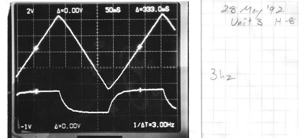

If you have the ability to drive a triangle wave current through the primary winding, instead of your sine wave,
you'll see that flux doesn't follow current because of the time lapse necessary for magnetization to proceed from the periphery to the center of the core.
Simplest explanation for that is eddy currents in the core - your primary isn't the only current present - but old timer gurus at Westinghouse assured me there are other phenomena at play too.

Seriously - try a triangle current waveform , and at various frequencies.
The triangle current gives constant dΦ/dt so should make a square wave voltage
Deviation from that square wave will tell you how well behaved is your ferrite core at each frequency
I'd be interested to see your waveforms as it begins to saturate.

A 400 series tainless steel shaft approx 3 inch diameter
excited with a 3 hz triangle wave current(top)
note rounded corners of voltage wave(bottom)

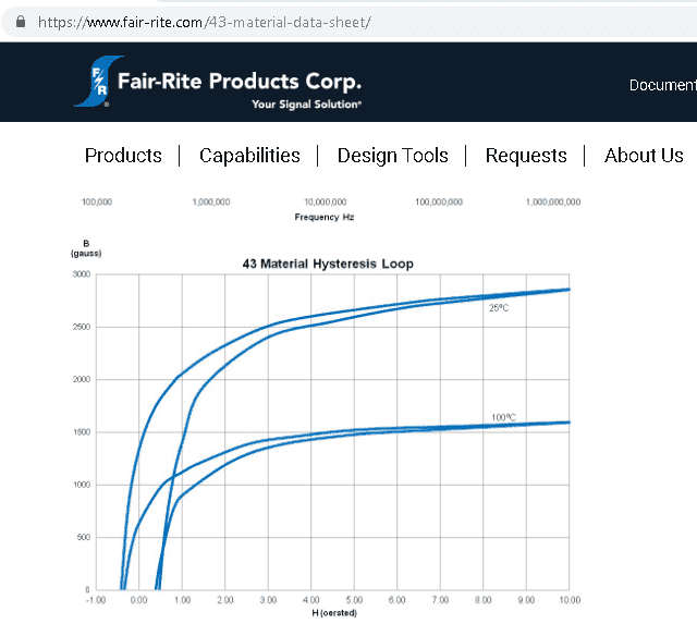

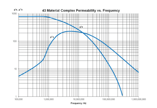

your 43 should be MUCH faster
245798
245799
Thanks, Fair-Rite corp !
